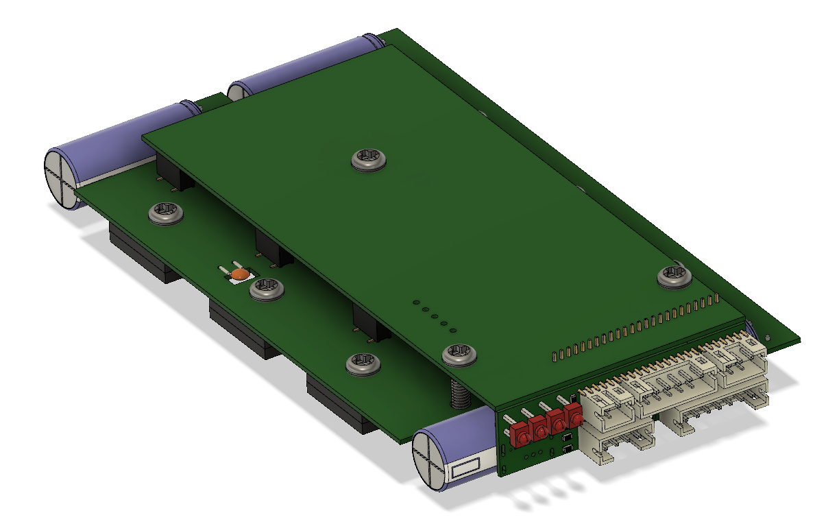

Post by shaman » Oct 15 2019 6:13pm
less shitty connectors.JPG (46.97 KiB) Viewed 2999 times
Ok. This should do better for connectors in the beta units.

Post by john61ct » Oct 15 2019 6:21pm
A single block however many pins needed, custom pigtail pinout spec'd for common connectors, maybe the "adapter" sold as an option in various lengths.
shaman   1 kW
Posts: 331
Joined: Dec 10 2018 7:03pm
Location: Fort Worth, TX, USA
Re: Serious FOCer (84V VESC 6 based controller)
Post by shaman » Oct 15 2019 6:32pm
@john61ct I like the adapter idea for the ebike crowd. Might be tricky to figure out how to work that in...
Maybe simply JST to "insert common ebike connector here" adapter pigtails?
if all you know is theory, then you're only theoretically intelligent
john61ct   100 GW
Posts: 5625
Joined: Dec 18 2018 2:06pm
Post by john61ct » Oct 15 2019 8:14pm
They aren't robust enough physically IMO.
The ones that are similar to what used to be used for robust "ribbon cables" on PC boards internally,
probably designed for 6-8A rather than JST's what, 3A?
Something where the crimping doesn't look for a $50 tool

Post by fechter » Oct 16 2019 8:33am
shaman wrote:
Oct 15 2019 6:13pm
That looks pretty good to me. Much better than the separate end board.
Post by coleasterling » Oct 16 2019 10:41am
Yep, I like it.
