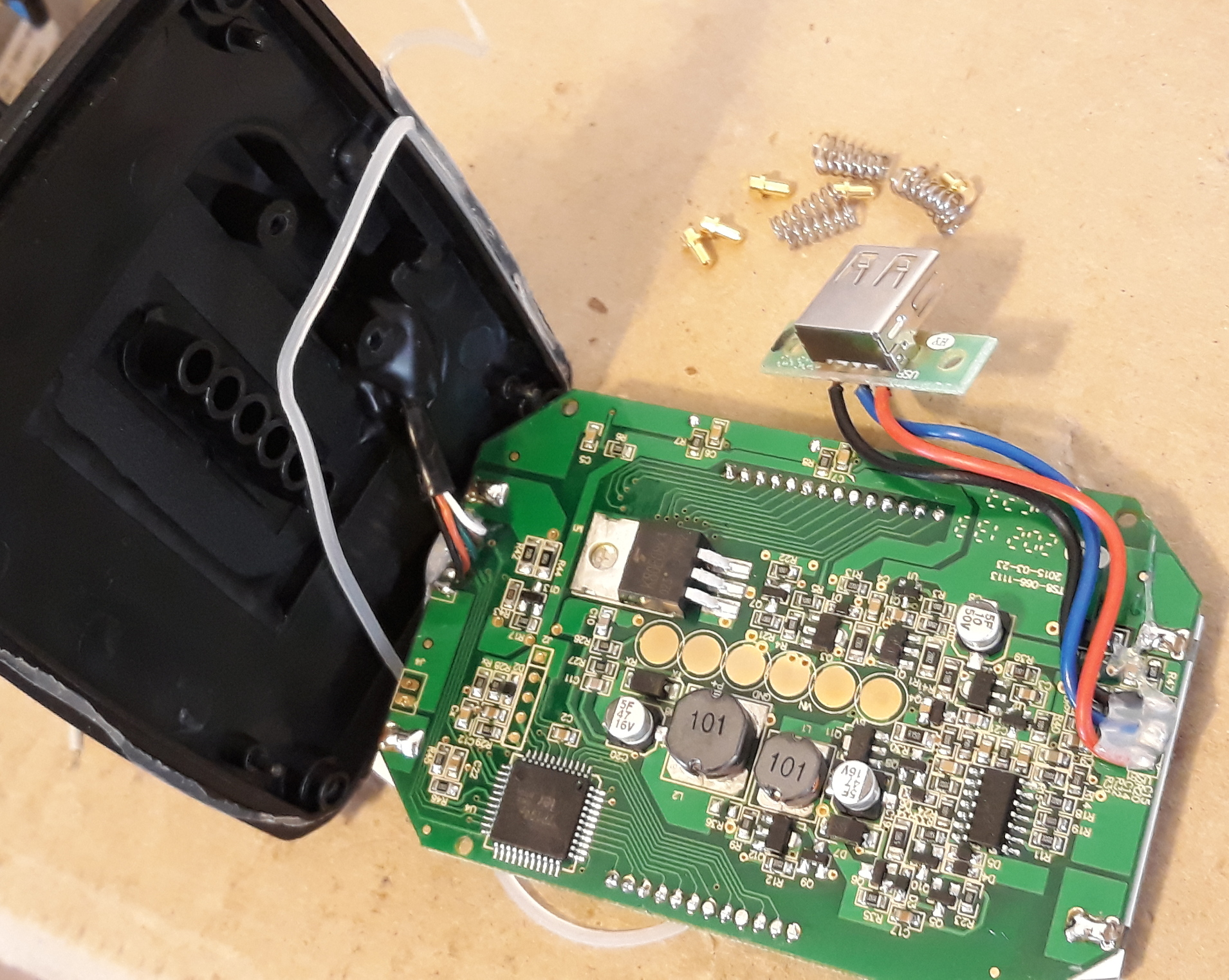

First code runs, the traditional “Hello world” using printf() :-)
The sources for the firmware, were I put this very first code, are available here: https://github.com/OpenSource-EBike-fir ... r_firmware
And I got more info about the VLCD5 -- see all my notes here: https://opensourceebikefirmware.bitbuck ... VLCD5.html
NOTE: the motor controller can be enabled by simple connect green wire to white wire and this way there is no need to use LCD.
Cable from motor controller | PAD on LCD PCB | notes
• green | P+ | battery voltage!!
• black | GND | ground
• white | Vin | ground when LCD disabled and P+ (battery voltage) when LCD is enabled
• brown | RX | UART TX motor controller
• orange | TX | UART RX motor controller
• purple | not connected | this cable is not connected to any PAD
• not available | 5V | the PAD has 5V label but seems it is not connected
