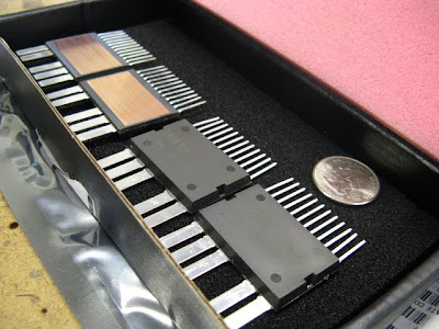

Post by rolf_w » Feb 10 2012 10:43am
yesterday I received the "Albis" ; thx Bas !! now I have to build a power stage (ca. 100V / 100A_peak needed) for which I require input/feedback from the experts here. I'd like to start with Shane Colton's 3ph Duo (v2.1 / v3.1) design for the power stage (http://scolton.blogspot.com/p/motor-controllers.html and http://web.mit.edu/scolton/www/3phduo.pdf). He happily uses the http://ixapps.ixys.com/DataSheet/GWM100-01X1.pdf which seems a very cost effictive full bridge (ca. 20USD?)
Image Image
If this or a similar power stage is readily available I'd prefer to buy it. If I'd start from scratch but keep with the GWM100-01X1 which driver would be suitable? anybody has experiences with gate transformers?

IM no expert but I think I have a good understanding of this. When you see a spec like 90amps max and 100volts max for a mosfet or H bridge etc. It means You will NEVER SEE THOSE NUMBERS. Here is why when the controller is PWMing the fets the amperage builds as the pwm fet is in on time and it builds till the controller says long enough for what ever reason (current based or pwm time is up etc) the point being when the controller says long enough the amperage has to be = or < the max of the fet rating or the fet will be destroyed. SO if you were realy good at setting up your power stage and all the settings in the controller you might get lucky to get the amps to build just to the max of the fet rating then shut off and if you acomplish this you will still get < the max of the fet ratings for phase amps. This is because the pwm will feed a pulse of up to or less then the fet max amp rating then shut off and the inductance of the motor will smooth out the current to an avarage of the on time vs off time. Make sense? Anyone think im wrong on this let me know but im pretty sure this is why many people look at the fet ratings as un realistic!

I kind of like the idea of this full bridge 'chip', it's compact design keeps many of the stray inductances in check.
About the 100A, I can imagine this is the maximum rated average current but that it can take much more A in peak ?
About the driver, I'm playing around with 4115's driven by the NCP5181 and it looks good so far. Driving single
4115's (for a 6 FET controller) it easily reaches 50kHz PWM freq with negligible shoot through even with sub 100 ns deadtime (66 V).
The gate charge of the full bridge chip looks to be about the same...
