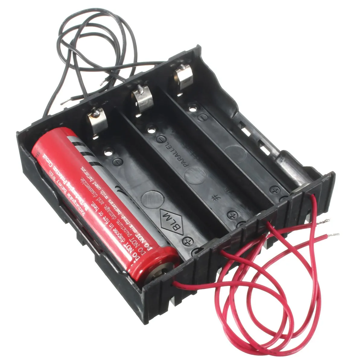

Anyone tried to build a pack with these 18650 cases?
Can we find out how much current they can hold?
Not very much if you plan to use the wire leads that they come with... I bought a 10 pack or whatever from CHINA china...china... :P anyway... I glued 3 of them together to give me a 6 cell holder. Makes it easy for balancing/charging cells IMHO. I think you can solder your own wire on the back of them...you just need to get a little crafty... I really like these kind too, they're way better than a spring holder...these really hold the cells well.

Post by vagosofron » Feb 28 2018 7:12am
I was going to solder a thicker wire obviously, but will that be enough? Will those little metal things that hold the batteries hold up the current? I want to build two 4s3p batteries, for a 60A esc. I hope using 12awg wire will do the trick.
That's pretty high amperage... Its hard to tell. They will probably hold the cells hard enough for an ebike but I'd still either do some removable tape or zip tie or velcro straps to ensure they stay in the housing.
I will use straps for extra safety, that is for sure.
I have a 60A esc ( dlux 60A from hobbyking), I hope it will work.
I've used these a good bit and I think 30A is safe non-continuous (used in 2s RC car); I've also done about 15-18A 30min continous and I believe they didn't get hot.
It's cool because a standard 18650 max discharge is about 5A so these handle about what the batteries can handle so its a good matchup (5Ax5=20A continuous, 30A max burst). At these ratings a regular 18650 will get hot more than the wires do. I also use wago connectors and they run fine (20A/32A max rating, not sure what difference this means but wago's are rated for AC)

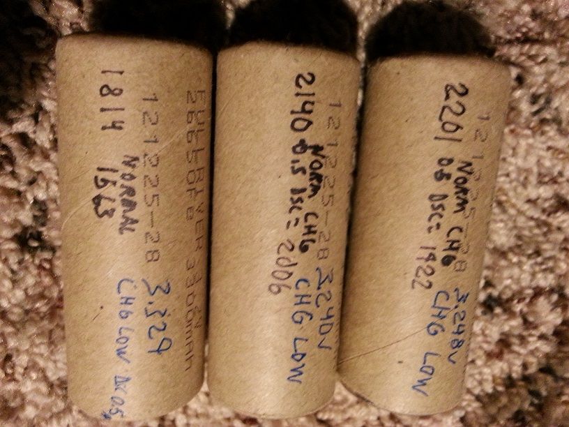

I've bought and tested the fullriver LiFePO4's recently and came up with some pretty inconsistent results
I wasn't able to get close to 3300mAh capacity (by a long shot) about 85% of the time.
Some ratings came up between 1000 to 2500.
I was charging at 0.25A to 0.375A and discharging 1A first like I do with 18650's but these batteries seemed to like a 0.5A discharge (imax b6) to get much more capacity.
I'm going to further test with consistent results to see if I can get some consistent capacities or if these are just bad quality/damaged cells which would be a good reason why they're selling for cheap (near $1/cell) and the company seems to be non-existent I cannot even find a spec sheet on them!

Post by DrkAngel » Mar 15 2018 7:59am
Similarly disappointed with the Fullriver LiFe.
Preliminary iMax cycle test (3.6V >> 2.0V) proved out near 2000mAh. (3.65V is recommended charge)
Experimented with LiFe charge 3.6V >> LiIo discharge 3.0V with poor results.
Accidentally ran a cycle at LiIo 3.0V >> 4.10 and got 3000+ mAh!
