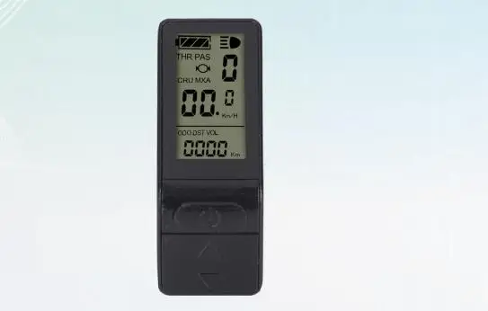

This looks super promising indeed. When you mean a "virgin device", you mean a sw102 with bafang firmware ? Because I have a unit here that came with a lishui controller. Looks a bit different.
There is also a KT version of the display that showed up on aliexpress, though it looks more like a cheap copy without OLED than an actual new version: https://ae01.alicdn.com/kf/HTB1eAx7VXzq ... -Parts.jpg

re: wireless update of a virgin device without ever having to open it
yes, that's the goal. Alas, our last experiment shows we are "close but still not working". I think our current status on this idea is on hold for a few weeks. We have some other things we want to push out for the SW102 and 850C before going back to this idea. So in a few weeks, after those things are finished I'll probably order another virgin device. But on that device I'll be more careful and run a tedious tool that uses JTAG to sneakily copy out the entire firmware from the device. Which will then allow me to debug and find the remaining problem and test solutions with the ability for me to "revirginmotize it" repeatedly while testing.
re: that cheap copy
Looks super amusing. Do you know of a link to purchase it? I might buy one to play with (as long as the LCD is not segmented, but rather pixels).

Is the KT-LCD4 and it is almost for sure segment. Get it here: https://www.aliexpress.com/item/33016875338.html
PSWPower sells SW102 for $35 while that segmented KT-LCD4 costs $30.

heh:
I guess that settles that. also: segments suck. ;-)
(Though I do wish the otherwise amazing SW102 they had opted for a transflective LCD - it seems the oled though sexy is a bit hard to read in direct sun)

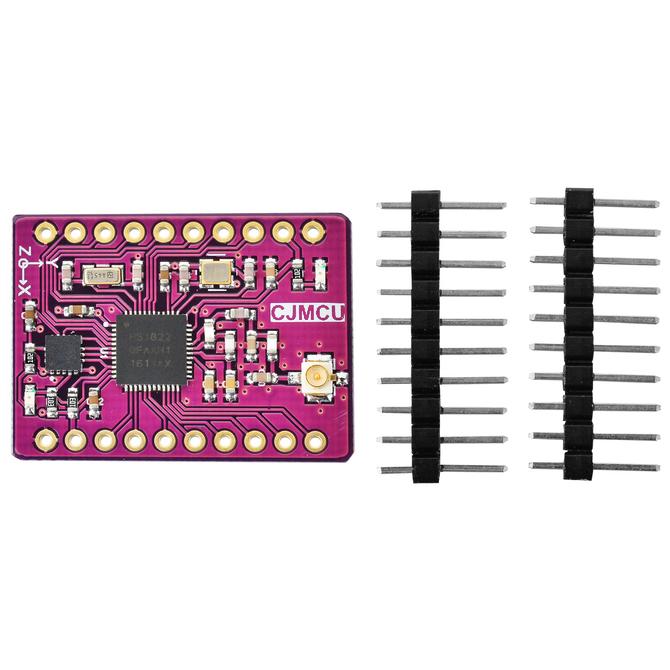

I would like to make a standalone Bluetooth terrain inclination sensor, so the SW102 could automatically increase/decrease the assistant level based on the terrain inclination -- more assist on hills and less on descends.
There is a 5 euro board on eBay that includes a NRF51822 (the same inside SW102) and an IMU -- see bellow.
The idea was to add a battery, a USB battery charger and a power switch, so the system could be placed on some fixed part of the ebike.

inclination sensor in a front suspended bike and worse in a full suspended is so so, in a road bike you can put it everywhere. Prons is a fast response, cons is sensible in a rough terrain. A road with a 10% gradient has only 6 degrees of inclination, 5% 3 degrees. Barometer is less sensitive in this condition but it requires more resources because it needs the variable of the speed
