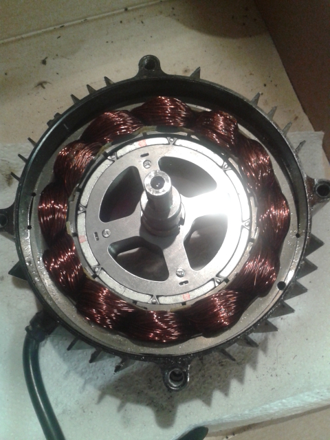

thank for reply.
i have open the motor, all is in place and dry.
I seem that the rear bearing (6201) is fautly.
