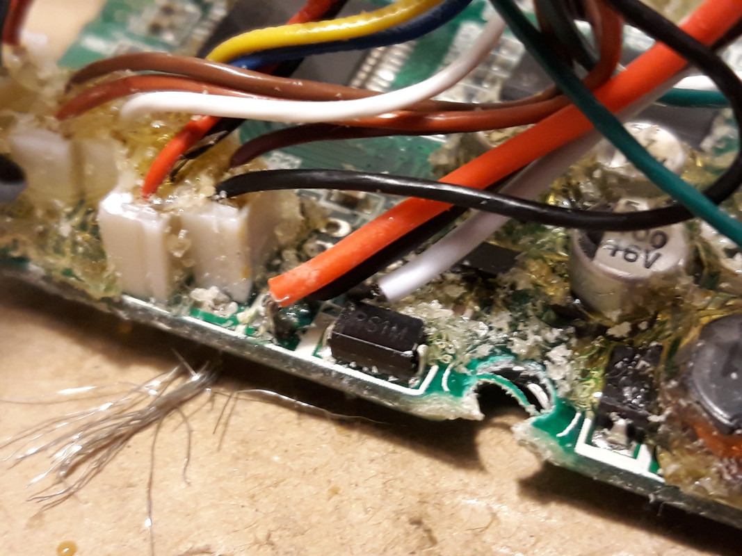

You can add throttle just by conecting the missing wire to the controller. I just did that and it works.
So, the thing is that the version without throttle, just misses the cable from the motor controller to the throttle.

Pictures!!

casainho wrote:
May 19 2018 9:46pm
Pictures!!
That is my throttle connector, with the 3 pins: VCC 5V, GND and throttle signal.
Please note that board is dead now and so I removed from the metal case to analyze it, etc.
