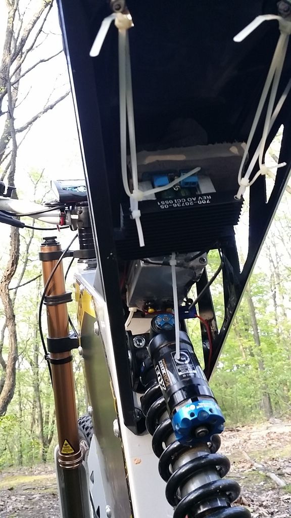

Been asking Allex lots of questions about the MAX E Set up, but figured I would start posting here to share the knowledge with those like me who don't know. I hope I am not the only one :oops:
So I spoke with a guy in Australia who is currently working on 2 bikes powered by the Adapto, both motors were smoked because the rider didn't have the timing program values correct and things were running hot. How do we know what optimal programming is as far as the values go? What would be the best setting on the MAX E for max performance out of a V2 MXUS 4T? Here is what I got from my advanced settings menu. I did change the #1 PWR Timing from .51 to 1.54, added a bunch of speed and power on to my machine :twisted: and it was already silly fast before I did this. Here are my settings and check out my vid which was before increasing PWR Timing
Angle Corr. -1.59
PWR Timing +1.54 was .51
Angle corr2 .51
Hall Offset 060
Hall Reverse NO
Wire Reverse No
Hall Inverse 0000
Wire R.Mohm 096
Wire R PHC No
Control Method Sine/// Sine
PWM 18KHZ
ADDNZ 05
GmagNeato   100 W

can you explain why they won't work with a crown ? I was just starting a new build with a crown and wanted to look into your controller for the bms feature along with other good things I have read about them . will you be able to fix the issue in the future ?
