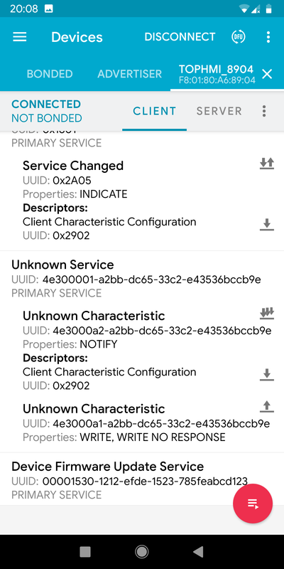

Post by casainho » May 07 2019 2:22pm
I did power on the SW102 I have here that I bought from PSWPower and has the original firmware. Bluetooth does work as seen on the NRFconnect app. Please see what you can find... can we find the company looking at the IDs on the screenshots??
The device name is "Tophmi_8904". Topology Human Machine Interface, since the company is Topology Tech?? -- I don't see it listed on Bluetooth site..... or maybe I didn't search correctly??

Post by Zelenaar » May 08 2019 2:11am
casainho wrote:
May 07 2019 2:22pm
Mine has the device name "TOPHMI_A001" with DFU available.
I didn't see neither a characteristic containing the name of the corporation.
Does an opensource project like this need to pay the BT licence ?
I don't think we are intending to sell the 'naked' product with the OS firmware on it.
Our users are buying a SW102 with already the basic BT software on it => I would assume its the resposibility of the manifactor the pay for the BT licence
The opensource project is 'only' offering an 'improved' version of the ootb firmware...
Another issue could be that we are making use of the Nordic softdevice, I don't know exactly the Nordic licencing but I think I read somwhere it was free for non-commercial usage
