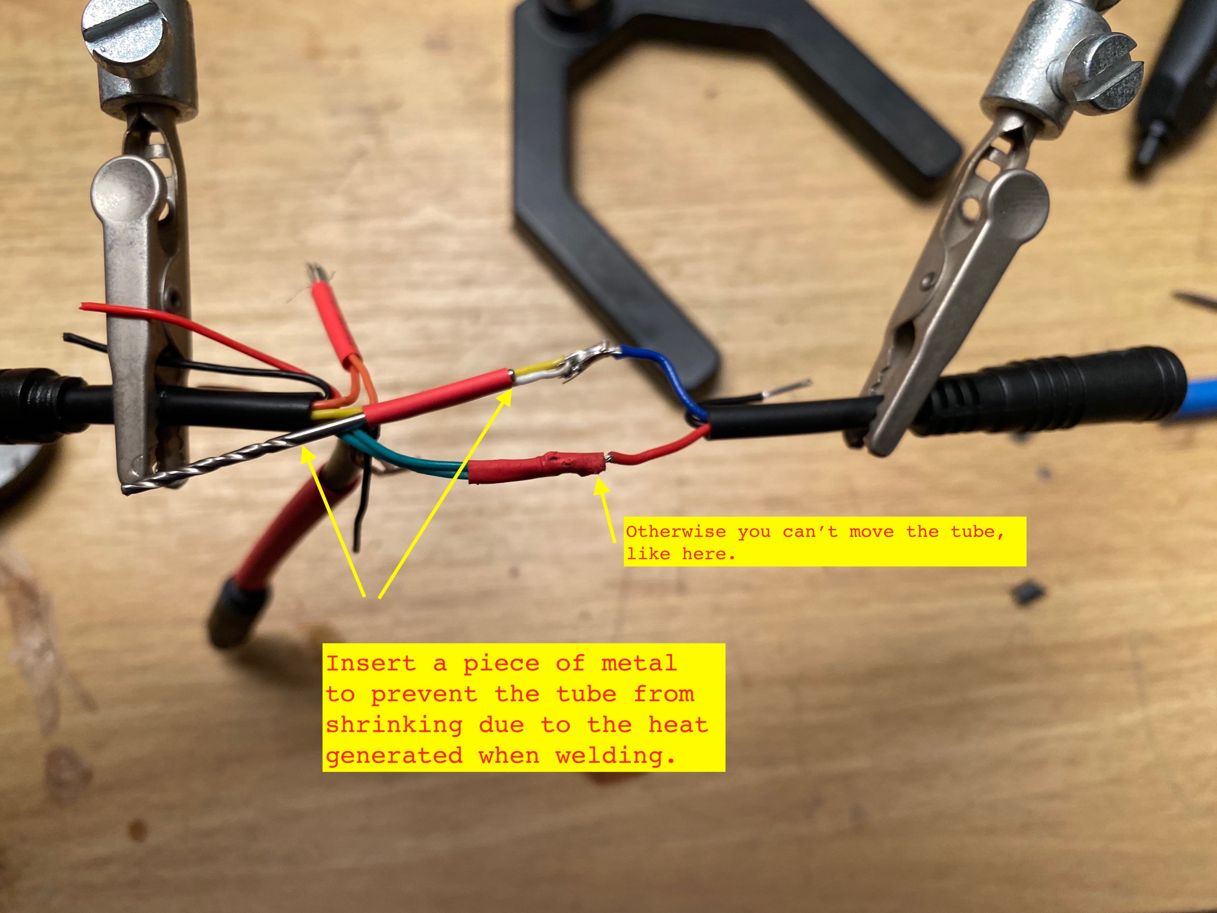

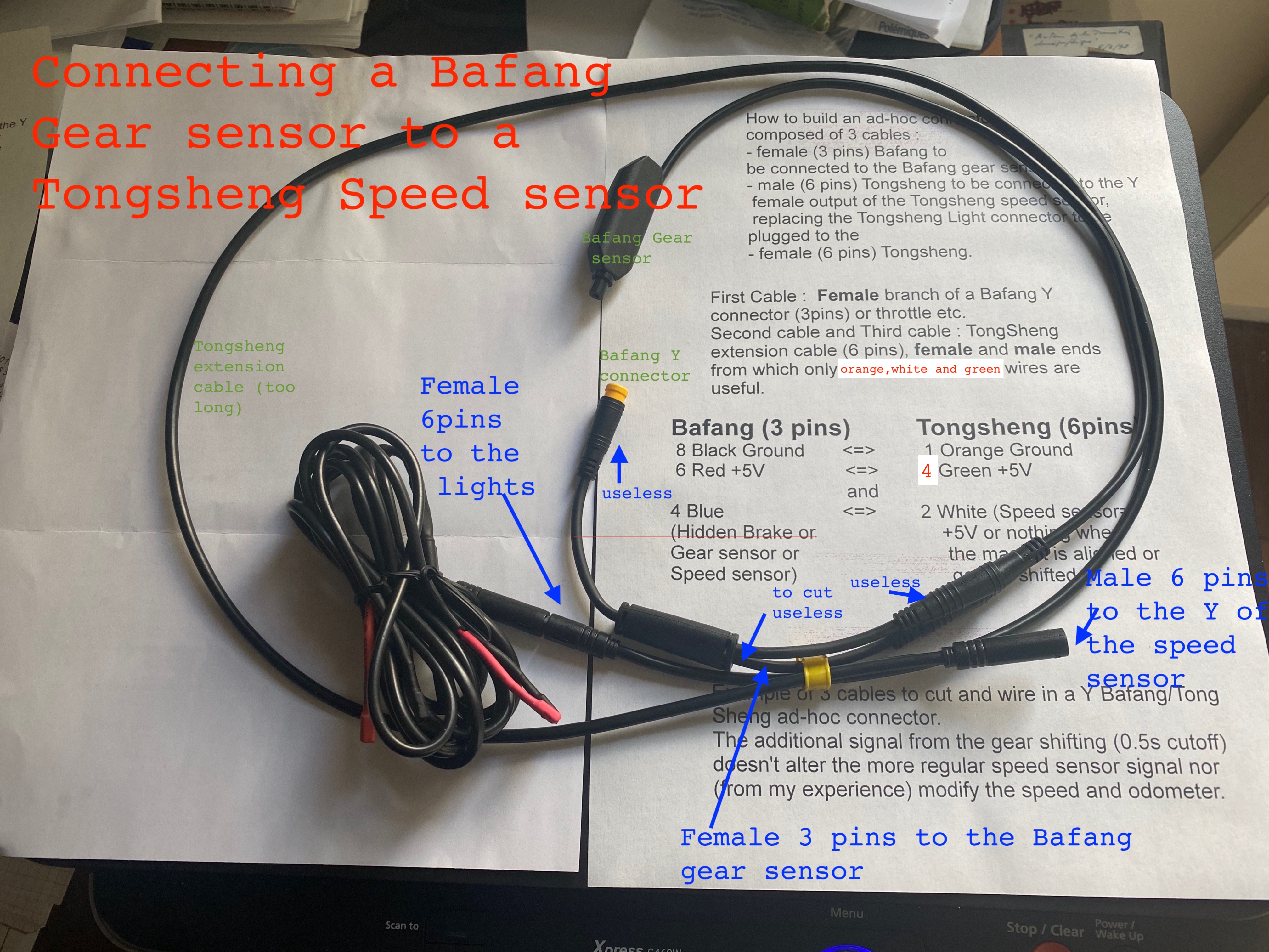

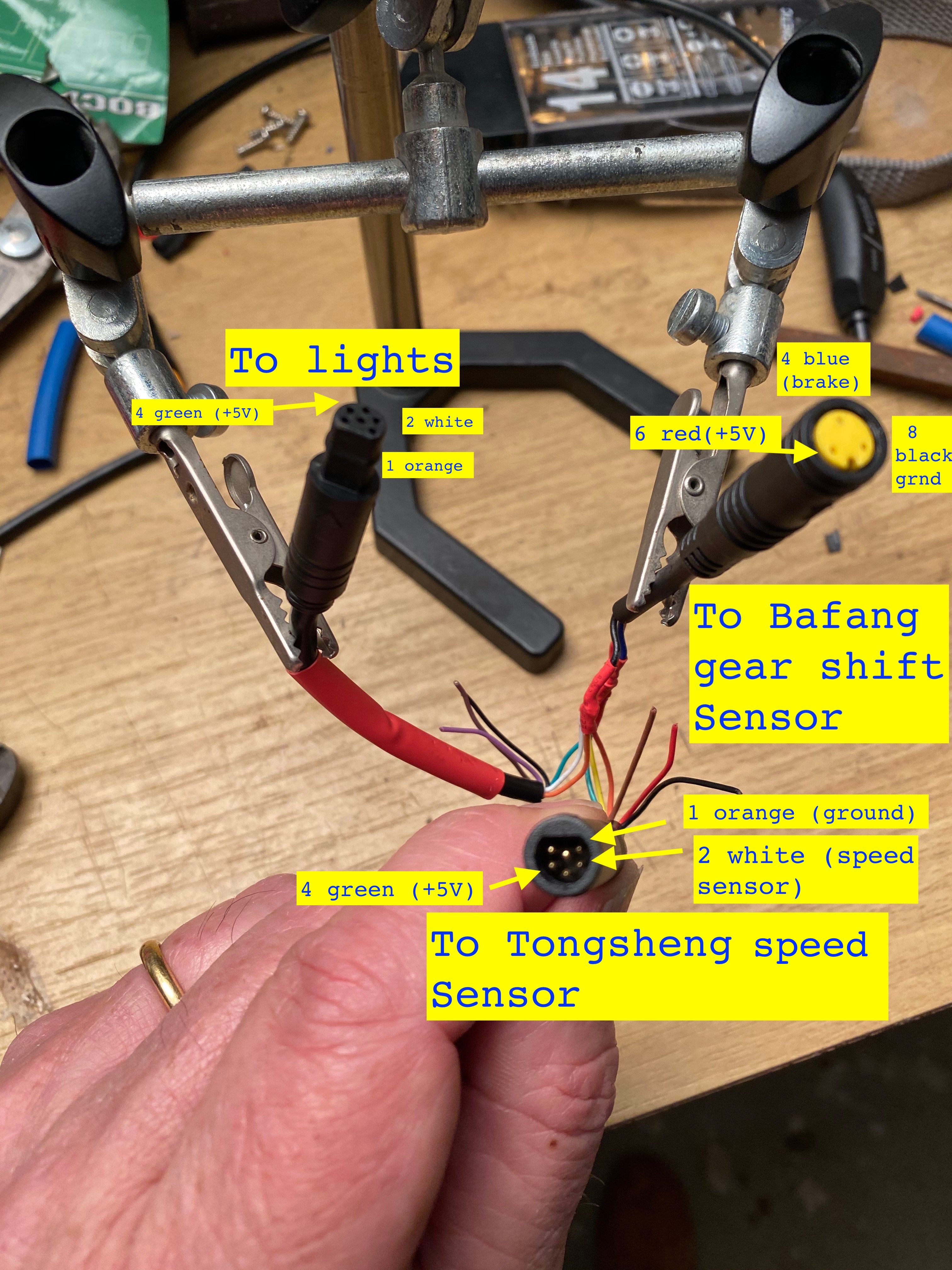

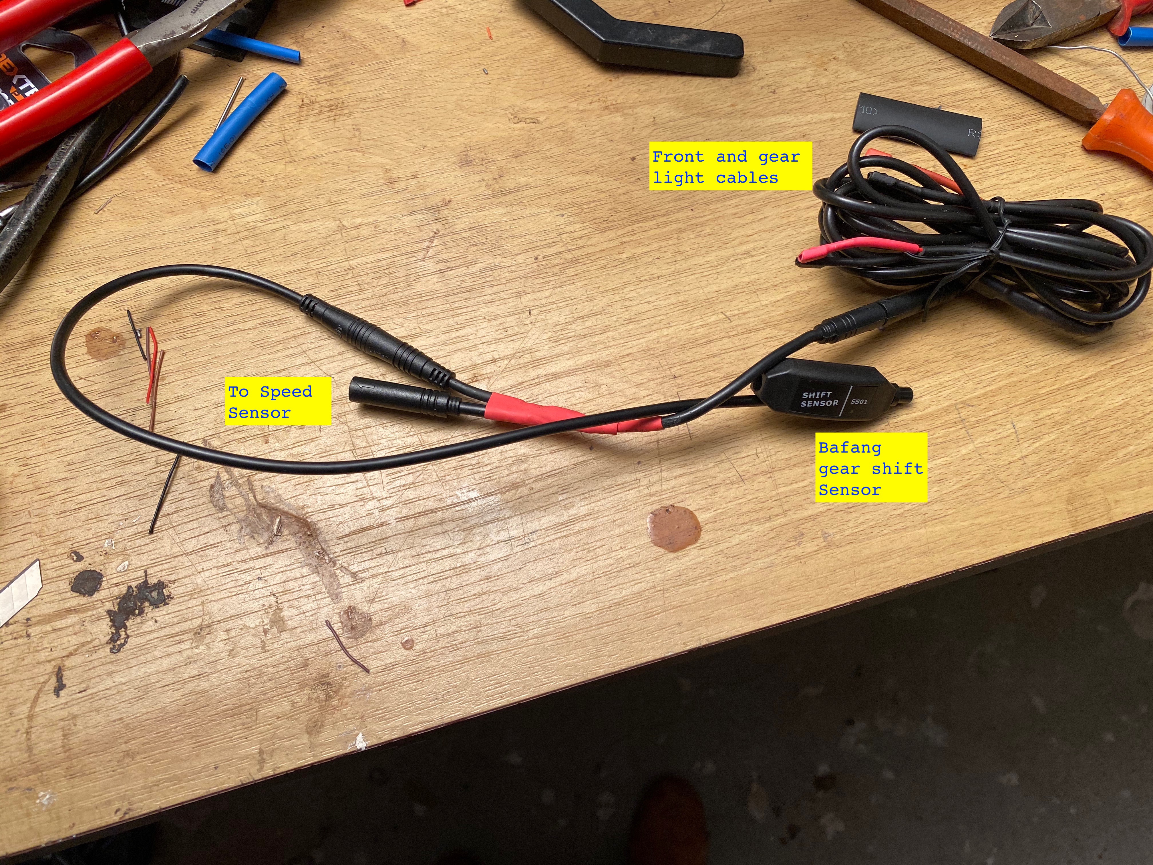

Post by revher » Mar 31 2020 6:32am
For connecting the Bafang gear sensor directly to the Y connector of the Tonghsheng speed sensor.
If one of the Y branch is used by the lights (it was not the case for my first bike viewtopic.php?f=30&t=98281&start=825#p1533489), we have to build a new connector with 3 cables as described on this (new) photo (TSDZ2 wires are described for example here and Bafang there). Image
Preparing the Y Tongsheng (female) -Tongsheng (male) - Bafang female connector.
Sometimes the Tongsheng extension cables have different colors, here the white (the 2) is yellow.
Be careful with the heat shrinking tubes: Image
And here the connector ready to be connected.
And there connected:

I made an error in the photo which has been fixed on the new photos (the green wire,+5V is numbered 4 on Tongsheng 6 pins). I added the references. Sorry,
New edit: Regarding the firmware fix, I guess you mention the recent improvements made by mbrusa. It is a real improvement and the overrun is much shorter.
However, when biking in a city (not these days, because Paris is empty and bikes are allowed inside a distance of less than 1 km from home) with a lot of people sometimes crossing at the red lights, that is not enough and I really appreciate my installation of the gear shift sensor. I just need to downshift the gears and the engine stops immediately.
Also, I really appreciate a much easier way to shift gear while pedaling (I have an internal gear hub with 8 speeds).
If this is new with the TSDZ2, it was not new with the Bafang BBS which has a new gear sensor output cable directly from the motor.
Unfortunately the Tongsheng (Higo mini-A) connectors are not sold or you need to buy 500+pcs.
Until this type of special connector is available from a seller, we must buy extension cables and perform soldering as I did.
Revher

Now I'm thinking about how to do this analog on the VLCD5. There are already 2 ports on the display for the brakes. I don't know how the brake function was implemented in the firmware for the VLCD5, but can I connect the two brake sensors directly to the display ports? Or do I also have to connect them to the 6pin LCD cable?
update://
Now I understand that the gear sensor works just like the brake sensor. As I understood Emma, she connected her gear sensor directly to the VLCD5 display, so I'll try that with my brake sensors as well - thanks.
Just be aware that the gear sensor requires 5v to run the electronics in the sensor. The standard brake sensors that come with the motor are purely a Closed/Open switch and the brake sensor plug has only 2 of the 3 slots populated (see image below). The VLCD5 brake sensor sockets do have all 3 pins available however, and one of the pins has 5v. You will need a plug that has all 3 slots populated.
I couldn't find anywhere to purchase the specific plugs to fit the brake sensor sockets in the VLCD5, so purchased the gear sensor that came with the appropriate plugs with all 3 slots populated.
https://www.aliexpress.com/item/33060254663.html
Below is the standard brake sensor plug showing the location of the missing terminal that will be required to get the 5v from the socket.

emr wrote:
Apr 02 2020 6:33pm
I don't know if I got you wrong or you got me wrong. I didn't and don't want to install a gear sensor, I just want two brake sensors. I don't see any sense in gear sensors, respectively I personally have no problem with the overrun fix.
Anyway, I understood the manual of casainho ( https://github.com/OpenSource-EBike-fir ... ke-sensors ) that the Bafang brake sensor has and needs only two cables. Then it would have worked great with the brake plug with 2 pins. But unfortunately this did not work. After a lot of trial and error I noticed that it works if you short-circuit the white and the red cable of the Bafang sensor.
But I didn't find the way elegantly and wanted to do without soldering anyway (for optical and stability reasons). Therefore I crimped all 3 cables of the Bafangsensor (with XH 2,54) and plugged them into the white connector of the TSDZ2 mechanical brake. So I made a fully populated connector by myself.
So it works fantastic :D. Thanks for your help
