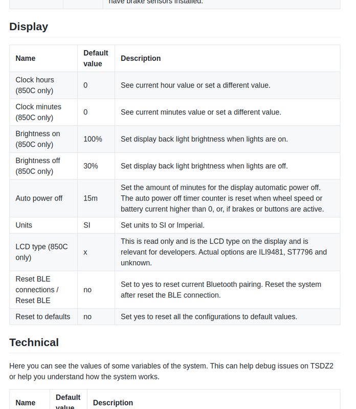

Did you manage to solve the most obvious issues for that 1.0 release ?
* auto power off not working (just found my battery completely depleted this morning)
* SW102 lockup issues in configuration mode - calibration impossible
* power cut-offs on bumps with default configuration. Root cause ?
Yes, all that points.
As new, the torque sensor startup threshold.
Also motor current control now defaults to torque mode.
Also default disable fast cadence stop.

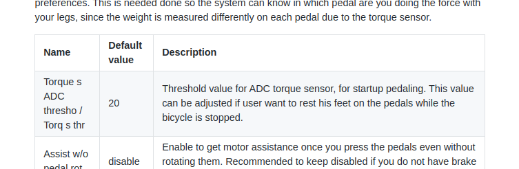

Post by casainho » May 27 2020 3:19am
Please everyone note the new configuration for the torque sensor startup threshold, it should help the users that want to rest the feet on the pedals at red lights:
