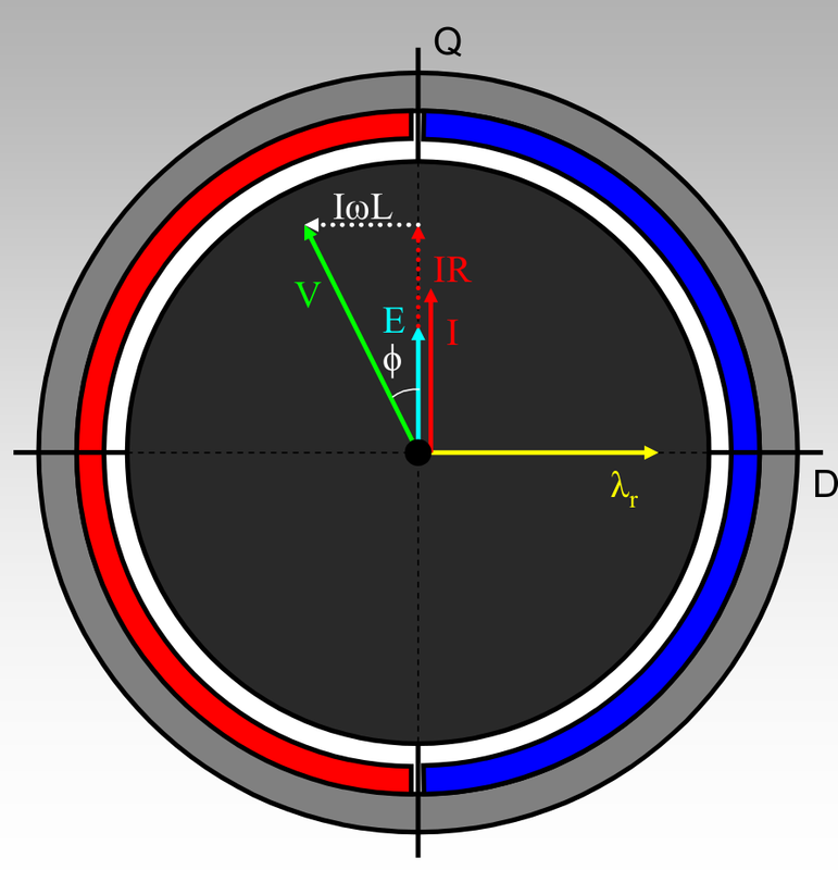

I thought the hardest part of this project would be putting torque sensor working but that was straight forward because I coild clearly see how the original firmware does.
Now the next part is math!! I am pretty sure there is an math/simple algorithm that has as inputs current and motor speed and outputs the motor phase current angle adjustment value we should apply to implement 'FOC'. I have app notes that shows that vectors and I need to understand the math operations... Anyone can help here??

Here: https://opensourceebikefirmware.bitbuck ... Cquals.pdf
Wee need to put I in phase with E. E is in phase is in phase with all sensors signals.
We can measure I module, E module (E = motor KV * motor speed ERPS).
V is our duty_cycle * battery voltage.
We need to measure motor coils L and R.
If there are cosines or such to calc, we need to use a table instead!!
- TSDZ2 OpenSource firmware

In order to do what is explained in the app note you linked to, you need atleast 2 current sensors (third can be calculated) and also these calculations are computation intensive (even with sine/cosine lookup) you should discuss with member Lebowski, He made code for a dspic30 with FOC. So he should have a good idea what would be feasible with the processor we have.

No point to discuss with someone that don't want to share knowledge - Lebowski firmware is not OpenSource.
I think this system does "the thing" with a different approach than traditional FOC. Even that app note, the author went with a different and simple approach than "traditional FOC". For instance, Kunteng controller only has 1 current sensor but still works very well.
After looking better, I think we need to calc the angle of that triangle with side: IwL; IR; V-E. I think is cos teta = IwL / (V-e).

I think you know the documentation of Shane Colton? He describes the determination of the best advance angle from the motor characteristics in detail on pages 48ff.
https://github.com/EGG-electric-unicycl ... 3phduo.pdf

I think will work as a triangle, with sides: V, IwL and (E + IR). I would go with sides V and IwL and that way, Sin teta = IwL / V.
I = (ADC_current*ADC_step)/duty_cycle
w = 6.2831853 * motor_ERPS
L = measure value specific to motor
V = duty_cycle * battery_voltage
Sin-1 ((ADC_current*ADC_step)/duty_cycle * 6.2831853 * motor_ERPS * L) / (duty_cycle * battery_voltage) = teta
where Sin-1 will be stored in a table.

Puh, this makes sense if the advance angle is already set to the right value. Says, current is in phase with the BEMF. You can't use the measured current if you don't know if you are in phase with the BEMF....
I think you have to do this approach:
1. measure the motor specific constants L (inductance) R (coil resistance) and Kv (Motor velocity constant)
2. derive V from Battery voltage and duty cycle
3. derive E from erps and Kv
4. derive angle between V and I according to alpha= arctan(omega*L/R) (see page 49)
5. solve the (non linear) equation system :shock: (iteratively?!, Shane Colten wrote, that he used a geometric solver for this, see page 51)

What about the sum of (E + IR)^2 + IwL^2 = sqrt(V) ?? seems to me that when I has angle != 0 with E, that equation in not valid... maybe iterative adjust angle up to get that equation.
Because that V and I has D components when angle != 0, but when D components == 0, we are where we need, just Q components.

Is using the inductance and resistance essential? If so, we need to include a config setting for 36V or 48V motor parameters.
casainho   10 GW
Posts: 4093
Joined: Feb 14 2011 2:43pm
Re: TSDZ2 mid drive -- Flexible OpenSource firmware for TongSheng TSDZ2 mid drive motor
Post by casainho » Apr 30 2018 5:00pm
jur wrote:
Apr 30 2018 4:57pm
I think is a must for the algorithm to use Land R from motor and so yes, there are that 2 different motor versions: 48V and 36V, that both have nominal 4000 RPM.

The original firmware runs the motor very silently compared to the 6 steps/square wave/block commutation I implemented. I saw the PWM signals and are SVM just like used on FOC but I think they are simple doing "FOC" using motor parameters!!
The development is blocked because I don't know how to implement "FOC" using the motor parameters... Let's see if jur can help ;-)
Please find free time -- if you believe in electric bicycles, improving the environment, improving people's wealth life, on this project your work will have a widder impact simple because TSDZ2 is very popular!! A lot of activity on this forum thanks to it!!
STM8 is very near STM32, the same datasheet types, almost same development tools, the same peripherals, etc. Will be easy for you.

casainho wrote:
Apr 30 2018 5:20pm
casainho, I have no specific knowledge of FOC, but I have Electrical Engineering background with lots of math etc, so perhaps I can help with that. I need to have a bit more background though. I perused through the document that was posted above (the lengthy one with all the details on FOC) but I need to read it a lot more carefully if I want to help.
What do you mean by " I don't know how to implement "FOC" using the motor parameters"? Can you quickly summarize where you are and what you think is missing?
Jean
