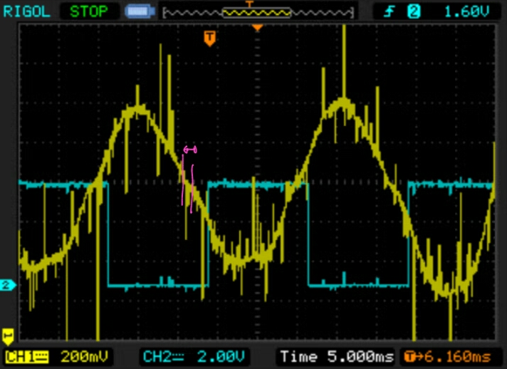

Post by jur » Jun 03 2018 10:55pm
casainho wrote:
Jun 03 2018 8:03pm
jur wrote:
May 07 2018 12:26am
That would be great. I am working on getting a simulation running on my PC based on Colter's work. It's slow going because of other commitments.
About the Sin-1, seems the input limits are -1 up to 1. Let's say I have a IwL = 8.5 and a Vphase = 4.8, 8.5 / 4.8 = 1.77... how can I calc the Sin-1??
You are right, the value must lie between -1 and 1. According to the pic I analyzed, Image,
V must be bigger than IwL.
Even for pic 1 just before it, same holds.
