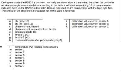

The hall sensor information from Arlo explains to me why there's trouble sampling the back-emf.
This is a plot from Arlo's hall data:
If you look at the graph you can see the hall spacing is really irregular and especially
series3 has a weird very high dutycycle (65%). The main killer for the sampling however is the
spacing between the series2 and series3 around position 45. The chip expects somewhat
evenly spaced halls (which would be a transition every 21 positions). It can deal with tolerances
on this but a spacing between transitions of only 7 positions is really out of proportions. What happens
is that the time between two hall transitions is extrapolated (using the known hall positions)
to the time for a full e-period. If this then differs more than 12% from the running average e-period
time it declares lock is lost and stops the back-emf sampling (basically it samples the voltages but
then has no clue anymore where in the e-period the samples were taken). With a very small
space between transitions the time between the halls is multiplied by a huge amount, easely
tripping the 12% max. error allowed.
Just to compare, this is the plot from the data posted by Nieles:
I actually have the feeling one of Arlo's halls is broken (hall 3), it would be interesting to spin
the motor with a drill (constant rpm) and to look at the output signal of hall 3. I think it will not
be a nice regular square wave. My reasoning: during the calibration the average falling edge was on position 41,
the back-emf sampling stops because of an unexpected hall transition at position 18 for the first
measurement posted and 12 for the second measurement posted by Arlo 2-3 posts ago.

The back emf posted by Nieles looks good, this is the raw sampled data:
and this then the reconstructed:
You actually discovered a feature :mrgreen: Generating the reconstructed data is actually
a 2 step process. First it reconstructs the waveforms to within a +1 / -1 range. Then it
has a quick look at the setup pin to see whether it's in motor or setup mode. In setup mode
it leaves the data as-is, in motor mode it scales it with a PWM frequency related value.
The PWM scaled data tells me it was generated with the setup pin in motor mode, this has
however no consequences for the stored waveform data.
Looking at the video of the sensored trials, I'm assuming there's no led in the video for drive_0 ?
Looking closely I can see that the controller does also go into drive_3 but exits it almost immediately.
Based on this the things I would change in the setup:
Code: Select all
a) loop sample frequency: 38.01 kHz
b) 1st order phase loop integrator coefficient: 53.0000
c) 2nd order phase loop integrator coefficient: 0.3099
d) amplitude loop integrator coefficient: 1.5000
e) maximum amplitude: 200 %
z) return to main menu
I would recalculate the values of b, c and d according to the setup manual. As it's a hubmotor, I would use
y=256. For unknown motor LR_delay, I would take 2 milliseconds as a slow guess. Then, with f_sample = 38 kHz and
f_pwm = 20 kHz:
option b -> 3.37
option c -> 0.005
option d -> 0.57
If it works you can reduce LR_delay. If it does not I would recalculate with y=1024.
Code: Select all
a) sensored or sensorless: SENSORED
b} sensorless startup: PUSH START
c} e-rpm limit sensorless self start: 1183
d} e-rpm reached before transition: 47 %
e} minimum current push start: 2.9 A
f} push start current, error allowed: 24 %
g] erpm sensored to sensorless transition: 500
h] transition time sensored to sensorless: 99 milli-sec
i) return to motor start below 500 erpm
j) controlled slowdown for direction change: YES
k) phase current for controlled slowdown: 0.9 A
l) motor maximum, forward: 99.97 k-erpm
m) motor maximum, reverse: 39.99 k-erpm
n) motor standstill voltage threshold: 0.49 V
Here, it's better to have some hysteresis between options g and i. Try 300 for option i.
The time specified with option h is extremely short, I would recommend to start with
1000 to 2000 msec and work your way down.
By the way, as the motor was running OK in sensorless mode I think the issue is in the
running modes menu and not so much in the control loop menu.

did some more testing today, but i cant get the motor to spin with a load to to motor.
i am in push start brushless mode, and when i spin the motor and try to put a light load to the motor(with my hand) it cuts out (to drive 0 )
i think i am tripping either the menu d, option f or menu d, option g.
settings tested
menu d:
c: 40 A
d: 15 A
f: 5 A
g: 5 A
Menu d:
c:100 A
d: 15 A
f:10 A
g:10 A
Lebowski   1 GW
1 GW
Posts: 3348
Joined: Jun 28 2011 1:38am
Location: beautiful Zurich, Switzerland
Re: Lebowski's motor controller IC, schematic and setup manu
Post by Lebowski » Mar 03 2012 11:31am
There's a good chance the problem is in the control loop menu, options b,c and d (the values for
which the computations are given in the setup manual). Having these values too large will make the
controller effectively jump all over the place (as the updates are too big).
You right in thinking you're tripping menu d, options f & g (the error current settings, error current trip
level is calculated as option f + amplitude * option g, with amplitude in the 0..2 range). This can be
caused by the controller jumping all over the place due to too large control loop settings...
Did you try the suggested values I PM-ed you ? Can you PM me the contents of the menus ? Hub motor or RC ?

I think it is indeed the noise in the throttle line, calibrate it with a bit larger deadzone. The controller IC
has the option to give internal variables out during motor use (page 27 of the setup manual), looking at the

i have been meaning to ask you about the data output function, do i need anthing special to get the data from the controller when in motor running mode?
if i simply input one of the characters from the table i get no response from the controller (well i get a random character, but not a stream of data)
Lebowski   1 GW
1 GW
Posts: 3348
Post by Lebowski » Mar 08 2012 9:06am
nieles wrote: i have been meaning to ask you about the data output function, do i need anthing special to get the data from the controller when in motor running mode?
I think that's a feature of 'termite' :D
In termite you probably type 'a'-enter.
On the 'a' the controller starts outputting data but the enter character stops it immediately. Any character
the controller receives not in the table ('a'-'h') stops the data transmission.
In Ubuntu's gtkterm, after typing the 'a' you get a lot of data back immediately...
I use a labview program that transmits a single charater and then collects the 16 bit data and plots
a real-time graph. It'd be nice if someone could program something like that in python...

hm, maybe the programs must be started after the controller is switched into motor mode ? These programs
try to interpret any pulse on the line, also one from switching the controller on/off . Some of them freeze
on funny characters (it sends 16 raw data which is not supposed to be interpreted as ascii but as binary)
these are some results from my controller, this shows the phase in sensored mode transitioning from sensored
to sensorless:
this is the scaled throttle data with throttle constant, you can clearly see the noise:

Post by Lebowski » Mar 08 2012 3:21pm
yeah it needs a custom program to grab the data. Something that sends a single character (dependent on which data you want) and then captures all data the chip sends back. It's relatively simple if you know the programming language, I know Python is very general and easy but I`ve never used it before... is there a download for python under windows vista or xp somewhere with a manual ?
To capture the phase data would be very useful to see whats going on with your setup under sensored... only thing i can think of is that there's a connection wrong somewhere. For each of the 3 motor phases the pwm outputs, current sensor and backemf measurement channel must be correct...
