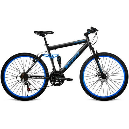

I'm working with limited funds myself, so I feel your pain. I have a few bikes I'm planning to sell so i can get a better frame to build up too. Full suspension is softer on the butt, but finding a good place to fit battery packs is more challenging than the ride comfort problem lol.
For best value/bang for your buck, the Motobecane Fantom series bikes can't be beat it you're looking to buy new. Wal-Mart has a cheap similar-looking clone called the Genesis V2100 for $149. Sure all the components are junk, but the frame is probably decent.
http://www.bikesdirect.com/products/mot ... 08NEW2.htm
https://www.walmart.com/ip/26-Genesis-V ... irect=true
