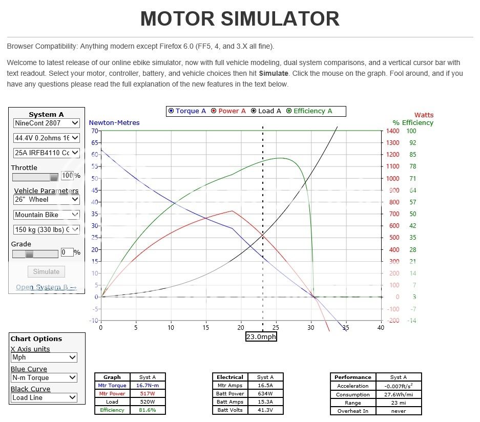

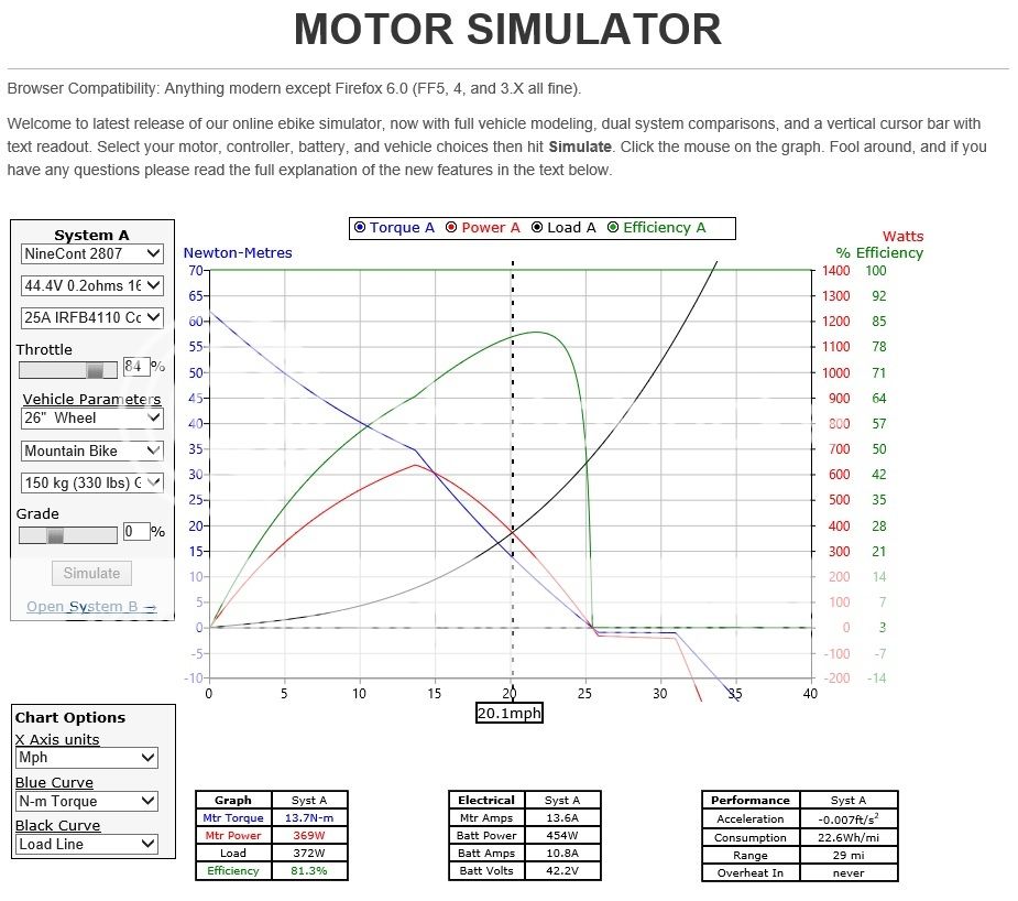

Here is a simulation using the Yescom (NineC 2807) motor and a pair of 16Ah Multistars.
Slow down to 20 MPH and range goes up to 29 miles.
Use the PAS that comes with the Yescom kit, pedal along and extend that range even further.
