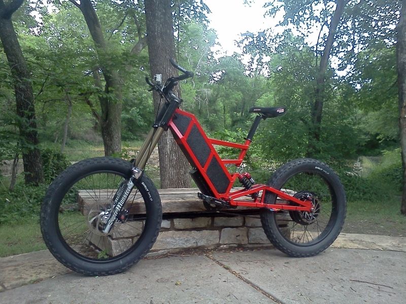

There are not so many fat bike suspension frames on the market yet. Best I've seen was a mod of a DH frame, with custom swingarm to accomodate 4". John is right about fatbike tires being thin and weak to be safe at higher speed. I prefer to ride on a 3" that is good, than on 4" that is not safe to hit. A good 4" tire is a trial motorcycle tire, and I find it too heavy to build on motorcycle wheels.
A good fat bike with 45NRTH tires can ride 40 MPH safely with the extra weight of ebike components, that would be the max speed that you should target with a fat bike IMO. On good 3" tires I ride above 60 Mph everyday, and much safer than a fatbike at 40 Mph.

MadRhino wrote:There are not so many fat bike suspension frames on the market yet. Best I've seen was a mod of a DH frame, with custom swingarm to accomodate 4". John is right about fatbike tires being thin and weak to be safe at higher speed. I prefer to ride on a 3" that is good, than on 4" that is not safe to hit. A good 4" tire is a trial motorcycle tire, and I find it too heavy to build on motorcycle wheels.
What I'm looking to build is very similar to the photo you posted, but I intend to make my bike look as much like a regular bike as possible, using a kit similar to this https://bmsbattery.com/ebike-battery/70 ... ttery.html. Do did you write a post on your build?
That is my street bike, built on a Trek Session 10 Large DH racing frame. 3" X 24" tires on 65mm rims are fat enough and very reliable at high speed. You can't have a fat bike that is coming close to handle like that bike, I can put my hands in my pockets and let it coast at 50 Mph, even on a rough street. It beats motorcycles on a start, corner and brakes much shorter than anything I've seen in 40 years of riding.

wesnewell wrote:None to the frame. It's much stronger than a regular bike and rated for 300lbs. I used this rim for the rear simply because I didn't won't to use the original rear wheel in case I wanted to go back to a normal bike with it.
http://www.weinmanntek.com/Products/CHOPPER/DHL101.htm
And the original tires aren't thin. In fact they are a lot thicker than a regular bike tire. I'd have no trouble with running them over 40 mph all day long.
Did you post a link to your build? What frame did you select?
wesnewell   100 GW
Posts: 7169
Joined: Jan 31 2011 6:25pm
Location: Wylie, TX, USA
Re: Components of a High Speed Fat Tire Electric bike
Post by wesnewell » Jun 24 2015 3:25pm
No, I didn't post a build thread. Here's a pic of the rear wheel.
Need Advice? https://endless-sphere.com/forums/viewt ... =3&t=66302
Mongoose 26" Ledge 2.1 mtb bike $99, yescomusa.com 48V 1000W rear hub kit $200, Hua Tong 72V 40A controller $35, 10ah 24s lipo $217=~43mph, range=45 miles @ 20mph. 25K miles and still going strong.
Huffy Fortress 3.0 with MXUS 3000 4T motor, 24s lipo, 96V 60A controller. Total cost with extras <$700. Top speed ~50mph
My videos https://www.youtube.com/channel/UC0KW4U ... _G2wQhptMg
