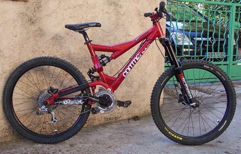

Hey folks wondering why there is a "seat tube" inside the rear triangle, it is welded to the rear triangle.
I want to fit a 6374 on it or cut it off entirely.

Probably it's for mounting a front derailleur.

It is welded to the bottom bracket, free from the swing arm. You can use it to mount anything that you wish. If you cut it off, leave a short part of it to avoid weakening the BB weld to the down tube.

I swear it's welded to the rear triangle
you can kinda see it here

Then it is not much use, if it is moving with the swing arm. Can’t use it to mount anything related to the BB and crank because the spacing does vary with suspension action. It could be used to mount a mud guard, or a disc side drive maybe.

I think it is on the swingarm on this design, which does make it move up and down a little relative to the chainring, but otherwise the swingarm would rise up and hit the deraileur.

Probably a limit stop to the suspension travel, or its just a rear triangle used also on a different bicycle all together.
What is the brand and model of the bicycle?

Its for hanging a front derailleur on, if you want a triple ring front gear. Can't use it to mount your seat, nor would you want to sit on it if you did. It would be like a hardtail, but moving all the time so it would yank your balls off.

Very odd place for a front derailleur mount. Its mounted to the rear triangle, which moves up and down over every bump, while the crank itself is stationary and apart of the main front half of the bike. Very odd location for a f.d. I was almost thinking it could have been for chain tension or mud guard mount, rear rack mount.

Come on. It is a DH racing frame. Absolutely no one using a double chain ring on a DH bike since the last century. I would guess this part of the swing arm was just designed common for two or more models of the brand.

Did I say it was a smart design? Maybe it's for a derailleur, that is used only as a chain guide.

Well, to design a part that is common to many models in production is not unusual. Car manufacturers are doing it all the time. This same part on another bike would accommodate a derailer mount, on the DH bike it does save the cost of making a part that is specific to a bike that is made in small series. A chain guide/tensioner could be mounted there, but they are normally part of the chain guide/ bash guard combo that mounts on the BB.

ended up buying the bike, here's what I want to do

You're going for a left hand drive? What is the dropout spacing?
Not planning to put the motor in the swingarm?

Dropout 135mm, don't want to cut the nipple in triangle

How do you plan to mount both the brake rotor and the sprocket on that drop out width (this is something I'm working on too.
Also if you are planning a jackshaft I'd mount it in that space behind the stub or else possibly on the swingarm pivot if there is clearance to the crank arm. Then your primary chain isn't going around two 90 degree bends.
