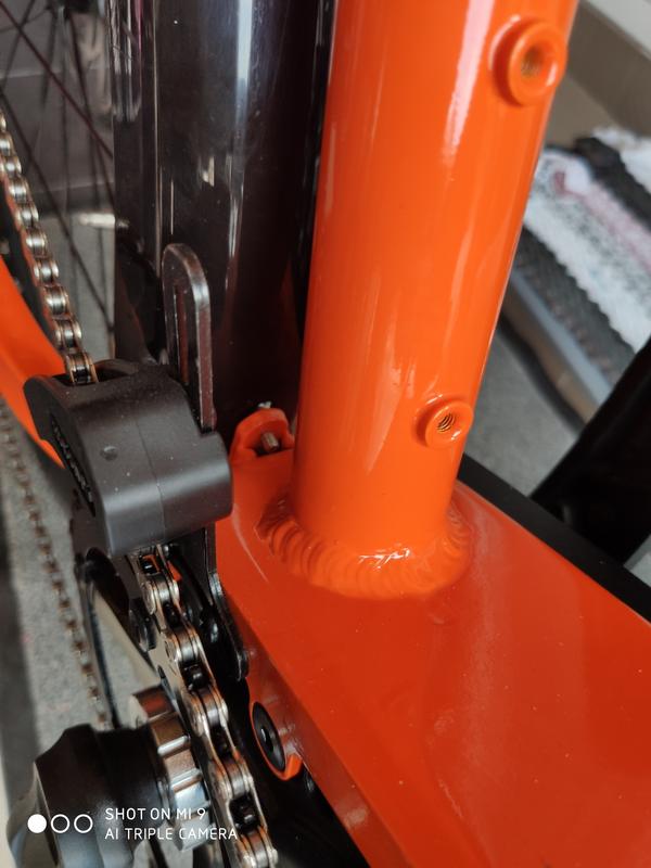

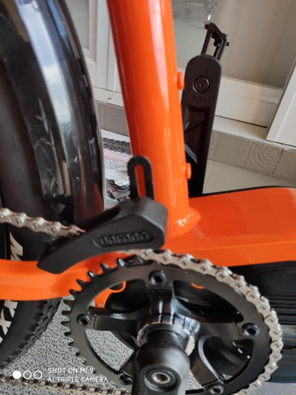

Post by Hardcore » Oct 13 2019 5:50am
rayebiker wrote:
Oct 12 2019 10:11pm
Hardcore wrote:
Oct 12 2019 6:57pm
If you didn't get it with the chainguide then you have to get the holes in there yourself. I did it as well due to too many chaindrops. But what have you been doing to your bike? Looks well used
Did you tap and die the holes for the guide? How hard is it to get the motor housing off to do that? (Or did you use some sort of self taping metal screws?) Can you send a few pics (as best you can since the chainring is in the way).
Yes, tap and die. Getting the motor off is quite easy but you have to undo the bolts and lower the motor out of the frame (you can keep it connected or disconnect as you like). Then you can tap two holes like in the attached picture and die them.
