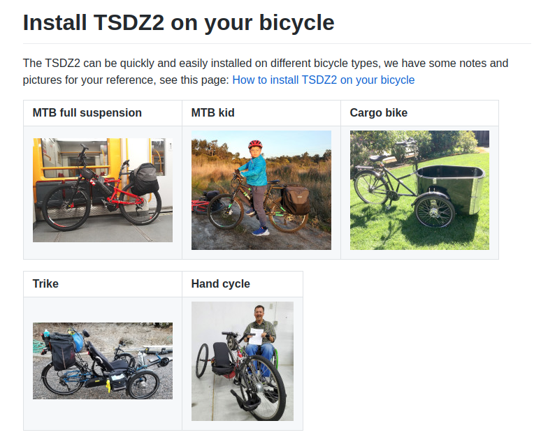

I updated the wiki on how to install TSDZ2 on cargo bike -- now I am looking for notes and pictures of installation on a fat bike, I think this is the last category left - anyone available to share his own notes and pictures?
