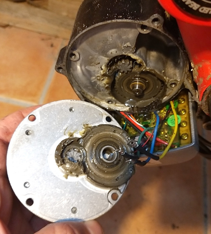

Another problem I got today while riding as usual, small trip of 5 kms around home. Suddenly, I could hear the motor working and see on display the motor ERPS speed at max values of 525 although no help assisting to pull the bicycle...
The motor shaft broke!!! Does anyone knows why did this happen?? -- then I exchanged for a new motor and seems to work fine again on a short ride but tomorrow I will do a long trip during the full day with my wife... I hope the motor shaft will not brake again.......

Post by knutselmaaster » Dec 28 2019 5:56pm
casainho wrote:
Dec 28 2019 5:11pm
Motor shaft failure is often caused by bad alignment.
If a bearing is not well placed or at a slight angle, or if the axle isn't perfectly straight, this gives a small fluctuation in tangential force causing fatigue in the metal that leads to breakage of the weakest point.
This can be caused by a badly made motor part but also by bad mounting.
If the motor cover (with the bearing in it) isn't 100% "flat mounted", in exactly 90° angle with the axle, or when the center of the bearing isn't perfectly in the center of the axle for example.
Generally it is noticeable if something like this is happening, the motor vibrates more than it should with the exact frequency of the axle.

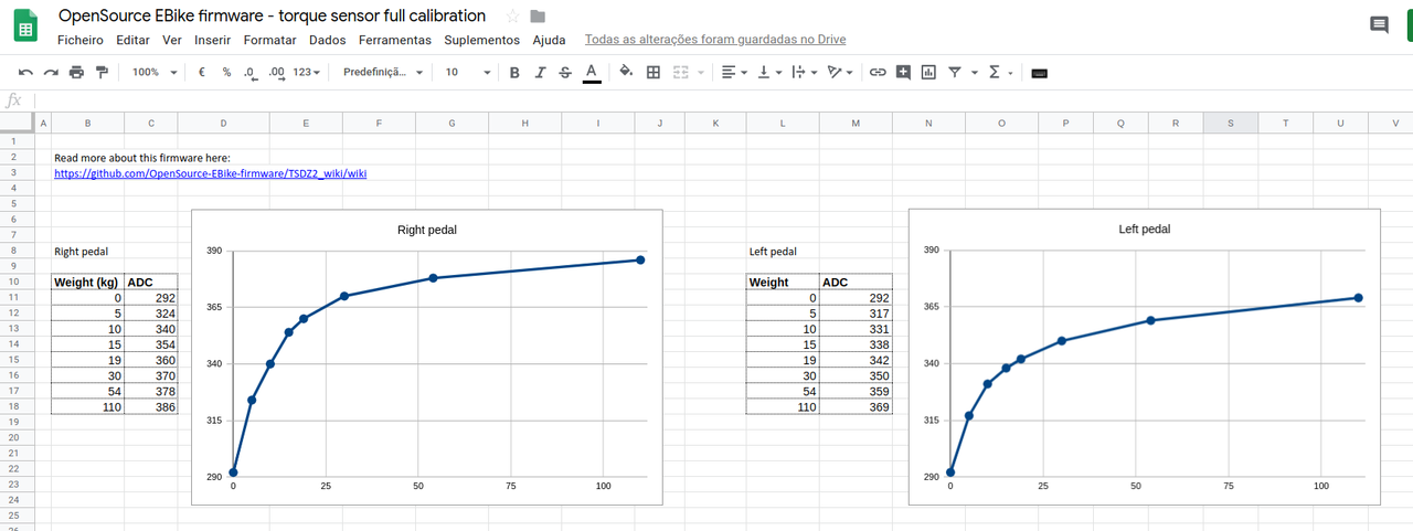

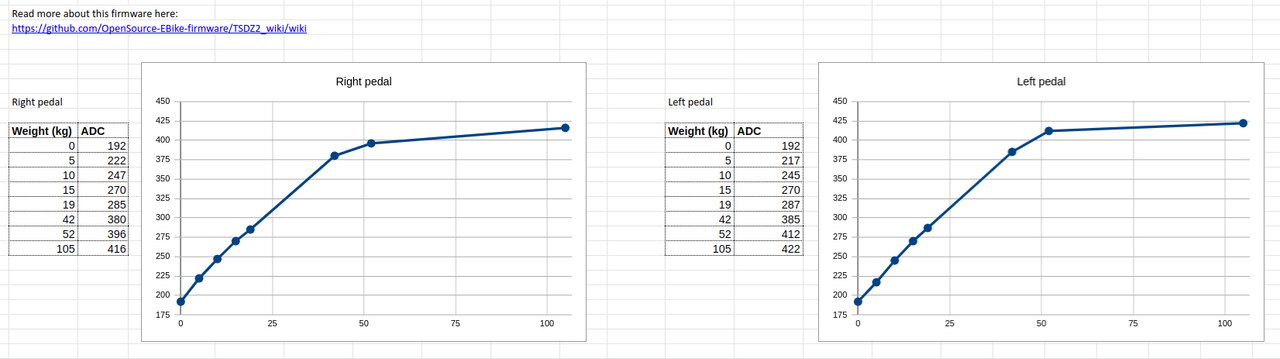

Post by casainho » Dec 30 2019 12:33pm
Improve your TSDZ2 torque sensor
Here is the new release of our OpenSource firmware that improves the TSDZ2 torque sensor: https://github.com/OpenSource-EBike-fir ... 50C_v0.6.1
(sorry, 850C only as currently we have an issue with the SW102 code)
Here is my wife bicycle and my bicycle the torque sensors measurements - the torque sensor of my wife TSDZ2 is way better than my torque sensor, here the comparison:
My TSDZ2 torque sensor:
My wife TSDZ2 torque sensor:
My notes:
1. One torque sensor is kind of linear only up to 15 kgs while other up to 45 kgs. The rate/sensitivity are the same for both on this "linear" zone but clearly mine lacks resolution because this zone is very short. I can do peaks of 40 or 60 kgs on my pedals without taking my but from the saddle.
2. One torque sensor seems to measure the similar values for both left and right pedals while the other does not (the left pedal has lower sensitivity).
3. The one that is worst on 1. is also worst on 2. So, clearly there are torque sensors that are worst than the others.
How to calibrate:
- go to Technical configuration menu to see torque sensor ADC value in real time
- use weights, your own known weight, weight from other members of your family or friends (mainly others with different value), put them on each pedal only (the pedal must be parallel to the ground)
- take note of each weight value and ADC value
- choose 8 points, first one with 0 weight value and last one with your weight
- use a copy of this calc sheet as seen on the next image. Draw a graph and choose the other 6 points near the knee zone as seen on the graph and not on flat zones. You can extrapolate some points if you don´t have the weights, follow the curve on the graph but try to validate with real measurements:
- go to Torque sensor configuration menu and input the data of each point: weight and ADC value
Torque sensor calibration table:
Seeing and validating the pedal side as also the weight measured on the pedals:
How to use:
- everyime you startup the system, the pedals need to be vertical pointing to ground. You can select on Configurations to be left or right pedal to point to ground at startup, based on your preferences. This is needed to the system can know in which pedal are you doing the force with your legs, since the weight is measured differently on each pedal due to the torque sensor.

andrea_104kg   100 W
Posts: 181
Joined: Mar 05 2018 5:51pm
Post by andrea_104kg » Dec 30 2019 5:10pm
casainho wrote:
Dec 28 2019 5:11pm
yes, I broke an engine in a similar way :-( Simply, in one of my 2 tsdz2 the engine did not want to disassemble and I beat it lightly with a hammer. I didn't notice anything but once reassembled, after 1km the engine broke exactly as in your photo.

Thanks everyone for the feedback, I added this information to the topic Known issues, how to repair and possible causes on the TSDZ2 FAQ: https://github.com/OpenSource-EBike-fir ... motor_axle
I replaced the motor for a new one and I did a trip in family on last Sunday, of 100kms. I also did other short trips yesterday. No issue until now.
I am being thinking about this, as I was very afraid that the issue could occur again on Sunday when I was far from home.
Recently I burned my motor controller in a very ugly way while I was developing the motor firmware. I had to take out the electric motor to see if it was damaged but it was not. Then, the axle broke in the next trip of 5kms. I used this for for long time, the only thing that was changed was the fact that I had removed it and put it back again.
Usually, in my TSDZ2, when I need to remove the motor, I can remove it directly. I have to disassembly the full motor by removing the long and thin screws - just then I can pull the part of the motor that is usually well fixed to the TSDZ2 case. Then, I need to assembly again the motor and screw the thin screws... I assume I did not do it well and the motor body/axle was slightly bent with reference to the TSDZ2 case where the bearing where the end of shaft connects. At least the seems to make sense with the information share by the others.
andrea_104kg wrote:
Dec 30 2019 5:10pm
casainho wrote:
Dec 28 2019 5:11pm
I think it is a fragile alloy that does not allow the slightest decline.
knutselmaaster wrote:
Dec 28 2019 5:56pm
casainho wrote:
Dec 28 2019 5:11pm
- TSDZ2 OpenSource firmware

Post by knutselmaaster » Dec 31 2019 6:07am
Axles are made of hardened steel. When steel gets hardened it looses it's flexibility.
In short, it's a trade in between wear resistance and flexibility.
