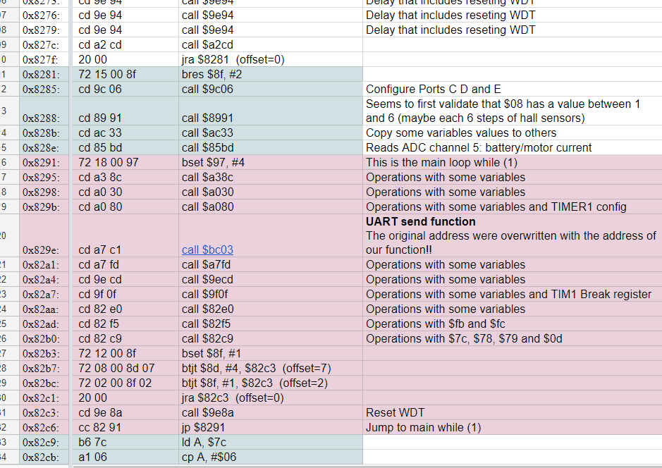

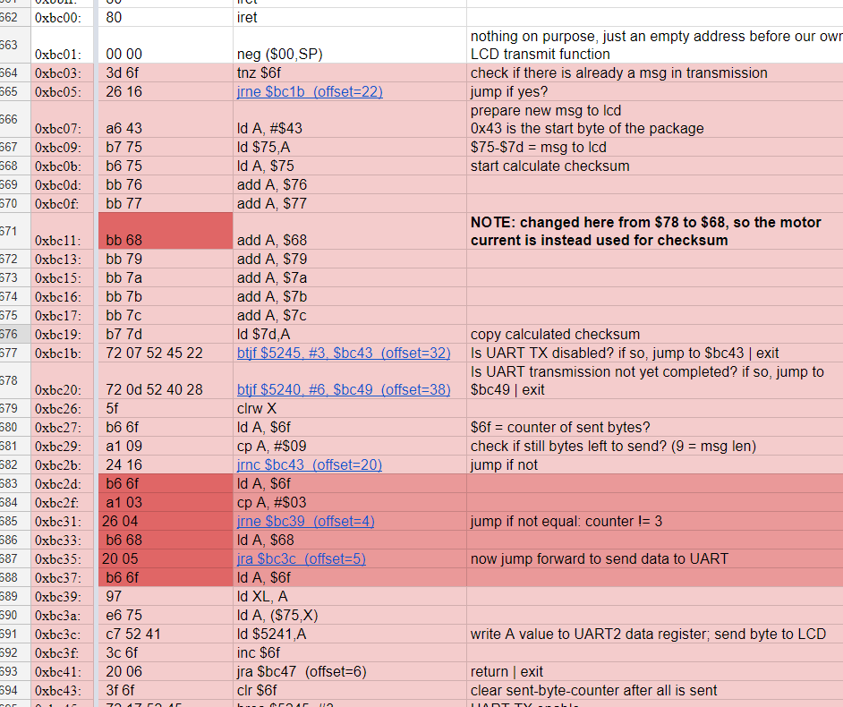

Here is the TSDZ2 original firmware with an improvement to send motor current to LCD (still original LCD does not read motor current). This is mostly for developers/advanced users that may want to use LCD3 instead of the original LCD or some Arduino, etc.
TSDZ2_original_firmware-Flexible.zip
(8.56 KiB) Downloaded 43 times
After disassembling we got good insights of some parts of the firmware do work. We could understand how data is sent to LCD and we could add our own function with the needed changes to send the current to the LCD.
Here is current disassembled file with our knowledge: https://docs.google.com/spreadsheets/d/ ... sp=sharing
And our added code at strong red color:

Finally got it!! TSDZ2 motor controller is now sending the motor current to LCD :-)
I developed the firmware for KT LCD3 to read the data sent by TSDZ2 motor controller and print it. Soon I should adopt LCD3 and recycle the TSDZ2 original LCD.
Here the piece of code that receives the motor current (battery current, actually) and low pass filter the value before print to LCD:
// low pass filter to smooth the battery current signal
ui16_battery_current_accumulated -= ui16_battery_current_accumulated >> 8;
ui16_battery_current_accumulated += ((uint16_t) ui8_rx_buffer[3]);
ui8_battery_current_filtered = ui16_battery_current_accumulated >> 8;
lcd_print (ui8_battery_current_filtered * 2, ODOMETER);

casainho wrote:
May 22 2018 10:31am
