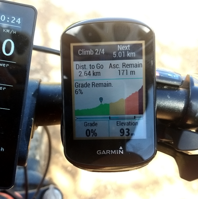

My current project is to remove the 860C display from the handle bar and use a Garmin instead, which have advanced features like in advance identification of climbs:

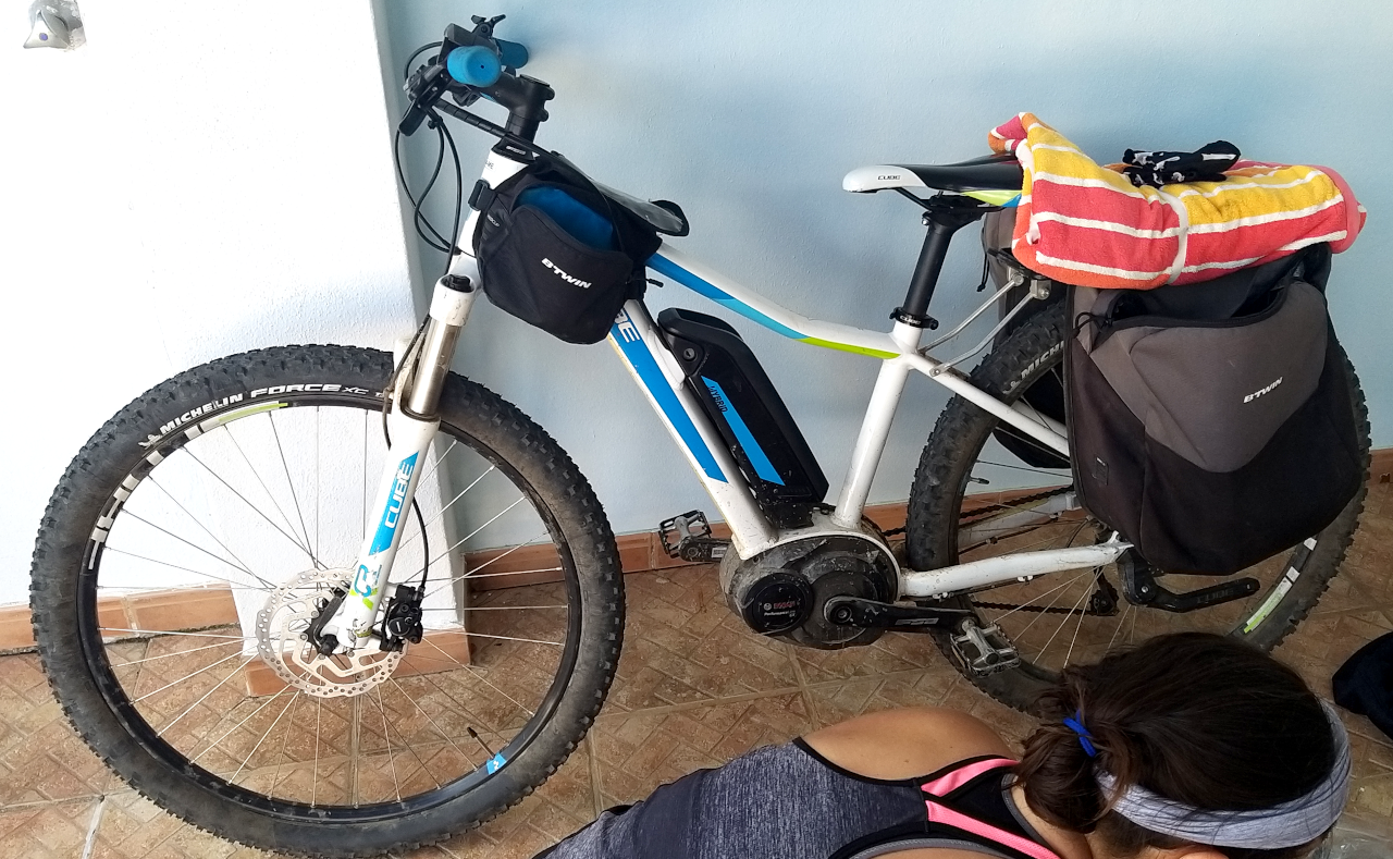

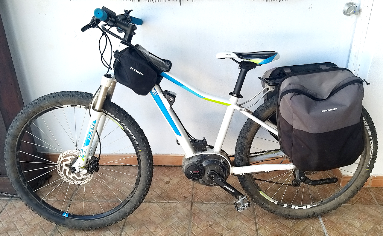

casainho wrote: Why not developing a 3D print base for battery pack that can be easily attached to bike frames and make a battery quick and easily removable? I am not a mechanic but I think could be possible and would bring a lot of value. I have 4 TSDZ2 ebikes and recently I did a trip of 5 days with family and friends, 3 TSDZ2 ebikes and 1 commercial with Bosch battery - this one was good because was easy removable to charge on the places we slept: would be great to have a similar solution to TSDZ2!! Any mechanical user able to design / develop a 3D print base?
My battery have a base with quick release using a key, but I had to remove it because it didn't fit inside this bike frame.
My plan for the future is to build a box for a small triangle battery, and this one goes back to my hardtail bike.
Last year I made a 4 days trip, around 400km, maybe you know the route "Rota Vicentina", it was awesome!

sp1n4d0 wrote:
Jun 16 2020 4:31am
I don´t need the lock, so only a base with a power connector would be enough. Here is the bicycle battery:
Yes!! we did the "Rota Vicentina" on this last 5 days:
