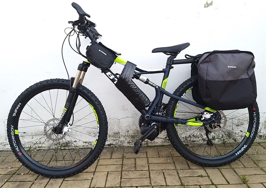

Here is my kid bicycle, M size frame, with the small and light battery pack 52V, 3,6V×3,5A×14 cells×2 parallel = 350Wh.
- TSDZ2 OpenSource firmware

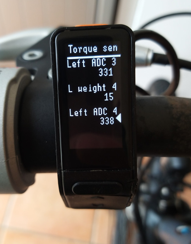

Regarding Torque sensor calibration, I fixed my issue which was a misplaced point within the 850C interface.
I am now running with the 0.6.4 firmware which works great, more sensitive; well done! I modified my calibration curve to ensure a minimum slope to limit the sensitivity of the inverse function (I set one last curve segment with a high slope protecting the inverse function from a possible sensor raw value shift, possibly due to temperature). I am not noticing anymore the superman behavior where human power suddenly get high. I suspect the root cause was sensor noise + high sensitivity of the inverse function.
I am sometime seeing one issue at initialization which make the human power measurement far too high (raw torque sensor value is ok). In such case, rebooting the system fix it. Once it works, it's all ok (never had to reboot during a trip).
One suggestion: my torque sensor value is 185 at rest while default value is like 280. It takes a while to set the 18 point. Maybe it is possible to ensure that all points entered are monotonically increasing. The benefit is twofold:
  • ensure no misplaced points
  • provide a quicker way to enters points, particularly when far from the stock setting

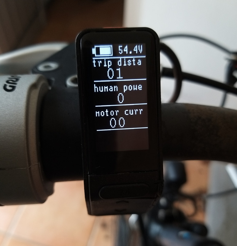

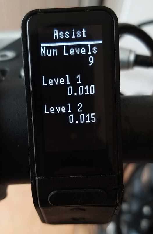

Hi,
I just changed from the LCD3 to the 850C this weekend, and must say it's a much better feeling from the motor, and it also feels a lot stronger if that's posssible. Great job!
I'm however struggling with some calibration issues. First ride to work yesterday, I completely zipped away on assist level 1, cutting five minutes of a 40 minute ride.
Before the trip back home I adjusted the lowest assist levels to that 1=0.01 and 2=0.02, and while assist level 1 is more reasonable now, the step to 2 is just too big and the higher assist levels feels like you're on a moped.
I calibrated the torque sensor last evening, getting resting values at around 140, and maxing out on 358/393 for my 85kg. This did no big difference to the assist levels.
One thing I've noticed is that my "human power" seems to be around 300w in my comfort zone, and I wonder if that's a bit high. Agreed, I've yet to learn how to ride a bike slowly and tend to push, but I'm not that fit nowdays.
Have I missed something in the setup? Is there a way to tune-down the power-level overall, so you can get better granularity in the assist level settings?
(And I agree on Lubins comment on torque adjustment, which is a bit tedious if your sensor reads so much lower than the defaults. Perhaps it could do 10-steps at a time if you hold down the button?)

ancan wrote:
Jan 28 2020 3:40am
Hi,
With the feedback already from some users, I am thinking to increase assist level to resolution of 0.001, this means that you can have the 0.01 (3 motor amps at your 300W pedal human power) and then increase on +10% step, to 0.011, so, 3.3 motor amps for your 300W pedal human power. But I think steps increase of 50% or not lower than 33% is the min the user will want.
About the torque sensor table, yes, I think it is a good idea to increase in steps of 10 units at long press.
This are things I want to do in short time.
About the human power value, I think it should be now the same across all users that calibrate the sensor. Still, let's see if someone can do a comparison with a calibrated measuring system, like Azur user that was thinking to buy a pedal power meter that is included on the pedals - I expect only a factor of maybe 0.8 or 0.6...

casainho wrote:
Jan 28 2020 6:10am
Please clarify. What is you need? And why?

arka wrote:
Jan 24 2020 7:26am
I'm starting to adapt the third bike for TSDZ2, of course under Custom firmware. It will be the 2015 Mondraker Summum on 27.5 inch wheels, a downhill bike:
So far I've made two such constructions for wife and kid:
My driving style is very aggressive, at full speed in the mountains and in the woods. Can you advise me or anything else I can predict. assumptions:
1. Shark 52V battery suspended under the frame as low as possible so that the wheel does not rub. Protected with aluminum sheet as in the picture:
2. To increase speed on flat ground, I will add 52T forward which I will manually change if necessary. I will add them like a user from this forum https://tiny.pl/tsrvj
3. I wonder whether to change the cassette on the back to 11-40T or whether it could not be better to use Nuvinci N380 / in which the gears can be changed under load or when stationary. According to the manufacturer's specifications, the hub is adapted to work under 75Nm load and max peak 90 Nm. I have such a hub https://tiny.pl/ts9tx or https://tiny.pl/ts9gb
4. I have a temperature sensor installed, but with my aggressive driving style, it overheats very quickly. From this topic I see that it is best to dissipate heat to the housing through steel sheets https://tiny.pl/tsrbh
Can I ask you for suggestions what to add, what to change?
A good bike for that purpose.
As far as shifting goes with an 8-9 speed casette you have the option of normal XTR "high normal" derailers that can upshift under load for climbing, or running a "low normal" Rapid Rise derailler and a gripshift that can dump gears sitting still. The shift will be preselected and will occur when the bike moves again. But not both. I run the Rapid Rise which does upshift under load OK but is spring loaded that way and not a solid pull on the cable. IDK if it's possible to run the old Rapid Rise derailer with newer 10 speed shifters or not. Might need thinner idlers?
As far as gearing goes I don't think a 52T chainring will do much for you on a 27.5 bike.
I'm basing this on my own 1500W BBSHD with a 50x11t top gear on a 26" bike. This is good for 36mph @100 rpm cadence. 2 things the TSDZ2 can't do. I don't think the TSDZ2 has the power to use that kind of gearing with that wheel size. If you lug the motor the Amps will go up and overheating will be worse. Power squares with increased speed. IMO 25-28mph is about what a TSDZ2 is capable of. You might get more on a skinny tire aero race bike, but you won't have much control doing it.
Here is a gear calculator. You can solve for speed @ 90 rpm and see what gear will work for you.
https://sheldonbrown.com/gear-calc.html
As far as cooling goes thermal pads/paste are good for eliminating air pockets to help conduct heat "between" parts. But metal has several times higher thermal conductivity. The best solution will use both methods.

SW102 firmware working
Finally I got the SW102 firmware working for the most recent version of motor controller, the SW102 and 850C uses the same firmware base (thanks to Geeksville developer!!) and so the same motor controller firmware. I hope today to make a new firmware release for both displays, where the assist levels factor can be configured starting from 0.001 and in 0.001 steps.
This means that for instance if I do 200W of pedal human power in average, I will get assistance of motor current of 2 amps if assist level is 0.01 (0.01 * 200 = 2) and I can increment in steps of 0.001, meaning next step can be 0.011, or +10% of previous step - this should give enough granularity for users to be able to adjust for their preferred assistance level factors.
