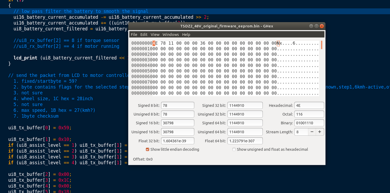

Assist level now works. I wanted to show the brake symbol on LCD but turns out that TSDZ2 motor control don't send the brake state to LCD :-( -- yes, I am using brakes and I really can't live with brakes connected.
0 assist level is the same as motor turned off.
NOTE: the values shown on LCD are twice of the real value due to a small mistake I did on the code.

I did some quick tests on an accentuated climb.
Assist level 1: max around 6 amps
Assist level 2: max around 12 amps
Assist level 3: max around 18.4 amps
Assist level 4: max around 18.4 amps
Maybe the difference between 3 and 4 is speed limit and not current limit.
- TSDZ2 OpenSource firmware

Nice,
I think the difference between 3 and 4 is torque sensitivity, where you have to push harder on 3 for the full 18amps, but you don't have to push as hard on assist level 4 for the 18 amps

I have the 36v 15A version..
Is it possible to get it to 18 or 20 Amps ?
Can we also increase the cadence or is this a limitation of the windings on the motor ?

jbalat wrote:
May 23 2018 6:46pm
Hi jbalat. Thank you for your videos on youtube about TSDZ2!
So, to resume:
On my EEPROM, I have the following values:
I think it is the 0x11 value, which 0x11 in decinal is 17, so 17 amps. I did read 18 amps but the things are not perfect so some were there may be an offset/error. You can try decrease/increase that 3rd byte on EEPROM and test.
I put the firmware of my 48V and 36V motors (firmware is just equal), eeprom and options bytes files. Just in case we need. You just need to play with the EEPROM file as it is were that option is saved.
Here the firmware files:
https://github.com/OpenSource-EBike-fir ... r_firmware
