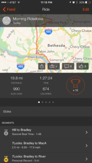

This is not a hyped review. I am glad that finally something worked as advertised. I want a reliable bike, b/c this is my car, and the GNG turd was not reliable, period. The BBSHD seems like another money pit... in a daily commuter you want overbuilt drivertrain to withstand the day after day abuse, and a single plastic gear on the gearbox with no possiblity of making it solid steel was a huge NO-NO for me. The Cyclone can be upgraded to steel planetary gears, or run two plastic and one steel planetary gear for a 100% bulletproof transmission.
To summarize my experience is that this thing has gone in 140 miles further and gotten to places where the GNG Gen2 simply couldn't dream to get, in over ~1400 miles of use. I have no affiliation with Luna, GNG, Cyclone or Bafang. I don't really care about brands all I want my bike to work when I plug the batteries and to date, this "humble" sub 400 dollar Cyclone kit has delivered on that with flying colors. Back when I was running the GNG Gen2, around the same mileage I have now on the Cyclone (140 miles) my GNG Gen2 had already broken the crank freewheel, broken the chain tensioner and snapped the motor shaft...
I guess this kit is not for everyone, but the truth is that there isn't much difference between installing this and the BBSHD; you're dealing with the extra chain, fine, which can be a nightmare if you don't know how to deal with that... On the flip side, you are not locked by marked up proprietary parts, components, etc..., which I personally don't like... I want my kit to do exactly what I want, not what someone else thought what I want...
