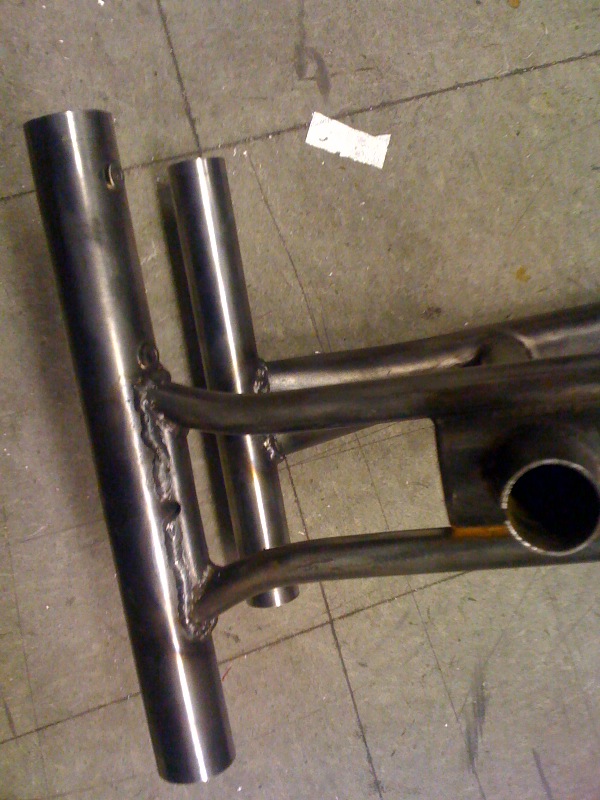

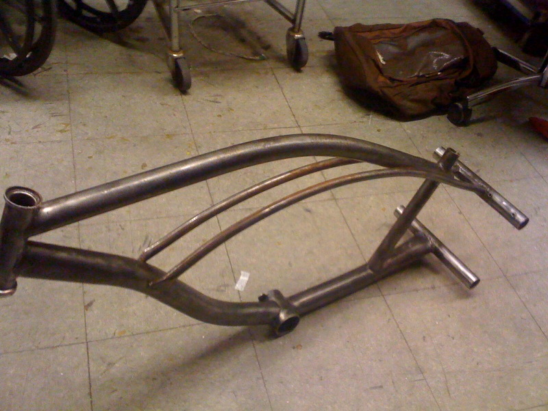

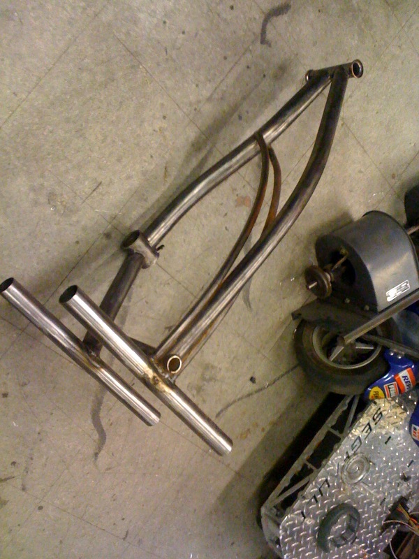

been getting some work done lately, had both setbacks and steps forward. I've ditched the steel ring as a motor mount, it was just too heavy and thick to weld onto the frame. so what I want to do now is have the motor mounted to a plate that spans four steel tubes perpendicular to the frame. I think the result will be both lighter and more elegant. Image
then I realized I had set the tubes too far back on the frame, the motor would not be able to be mounted unless I wanted to add almost another foot to the allready stretched frame. so with some burlier tubing I went at it again.
now the motor can be nicely tucked in there behind the seatpost. I'm going to use the 3/8" thick one inch tubing that I was going to build the springer fork out of to build out the new chain stays but what's got me held back right now is the steel plate to make the motor mount out of....argh!

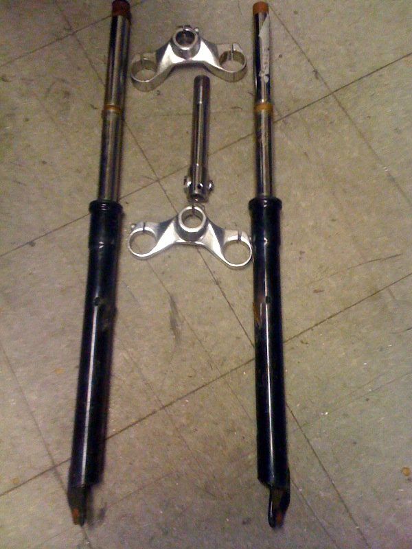

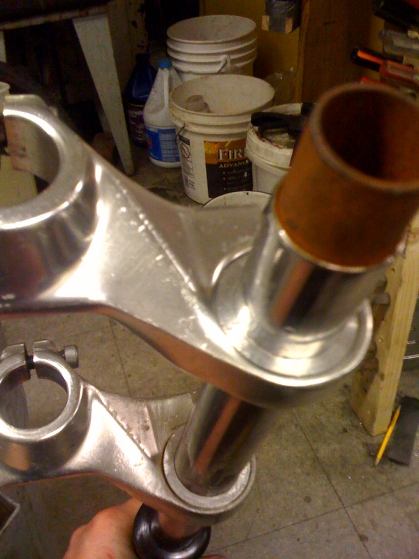

After many setbacks with building that springer fork I came accross a decent double crown down hill fork in the MIT bicycle graveyard. It was missing it's top crown. So I busted it apart so It can be mounted into some super sweet motorcycle crowns that a buddy gave me. I took great care to remove all hardware from the fork tubes.
one problem though, the crowns are meant for much bigger diameter fork tubes. so here was my opportunity to try my hand at the metal lathe for the first time. I turned some ali down and hollowed it out, cut out four rings and cut them into a C shape and wala!!! custom spacers to make the fork tubes fit.
as soon as I turn that steer tube from the original bike setup It should be fairly easy to mount the fork to the frame. I'll have to weld on some disk mounts but that should be fairly easy. If anyone in the NE has some steel plate they could stand to get rid of let me know if you want to work something out.

loving the motorbike crowns, you may want to consider relief cutting those shim/spacers though to ensure all your clamping force is getting directed to the fork rather than compressing the shim.
cant wait to see how this golden motor does for ya. very similar to what im doing with my stocker but more power. shall be fun to watch

what do you mean by relief cuts? The spacer is in the a "C" shape, and I made the gap about 5/16", the compression is pretty damn solid but you cant see the cut in the spacer in the pictures I took. I really can't wait to see what the performance is like in comparison to those mars brushless units, did you ever get yours opened up for pictures?
- be seeing you

gestalt wrote:what do you mean by relief cuts? The spacer is in the a "C" shape, and I made the gap about 5/16", the compression is pretty damn solid but you cant see the cut in the spacer in the pictures I took. I really can't wait to see what the performance is like in comparison to those mars brushless units, did you ever get yours opened up for pictures?
c shape is what i meant . beauty
