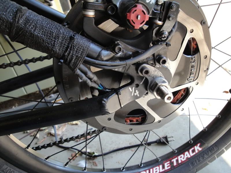

Allex wrote:Small holes wont do that much(they will work like airpockets), better to go with fewer larger holes(helps to scoop up Air). If you motor gets hot you probably have wrong tuning on the controller.
SUPPOSEDLY the theory of big center holes/small outer holes is that centrifigal force pulls air in center and out sides...more numerous small holes keep air flow on the hottest part of motor...thats the theory i guess
when you say "wrong tuning on controller" what specifically should i be looking at?

Korpin, do you do a lot of stop and go or are you just running flat out? Before ferrofluid I was able to heat up a 4T in a 17inch wheel to 90-100c with 20s dialed in at 40amps with some moderate hills and stop signs after about 6-8 miles depending on ambient air temp. This is about 3000 watts which is exactly to spec of what it is rated for I believe. When I run higher power I can get it to heat up quite quickly. Hopefully that gives you some sense of a similar setup. I would think that a 5T in a 26inch bike wheel would heat about the same as a 4T in a 17inch, but have not checked the simulator.
Any grease is better than no grease.

I still think korpin has a false phase combo. It shouldn't be very warm at those power levels.

Korpin, get the rear wheel in the air and check how many amps you are drawing with full throttle at no load. That is a quick way to tell if things are off with your phase/hall combo and you have a false positive.
i lifted wheel in normal mode and cranked throttle it jumped up to 17 amps then shot back down to 1-2 amps....settings in normal are 36 controller amps 81 phase amps

Korpin, are you sure you have your temp sensor settings programmed in correctly? The MXUS3k is a bit different. Did you double check that the ambient temperature is the same as ambient at least?

Hey guys, anybody tested v3 mxus with adaptto?
I have really hard time adjusting it because it overheats soo easily. By overheat i mean getting to 120 Celcius - which is temp limit for adaptto.
I tried different phase combos and got to the point when i have angle correction close to 0 (-0.8 to be exact) and timing of 330ms.
I still can reach 120celcius in about 7-9km moderate riding at 50A batt and 200A phase.
Is that normal?

I am pretty sure Allex did mxus 3000 and e-max for his Bomber, combo got him > 100 km/h. He pushed current to the max with OVS. Can't remember he was troubled by overheating. It could be wrong phases, or even some settings you have gotten wrong. 120 c seems high, are those 7-9 Km steep climbing, or more flat? Lots of stop and go or more cruising?
What turn count motor do you have and what wheel size?
If you are not trying anything extreme like 29"er I can't see why you should experience such high temp. Are your gauge correct? Check with ice cube or boiling water if you open motor.

Hehe I was thinking if you have the motor open, pry the thermistor loose and dip the end in hot boling water. Or use an ice cube just to check the calibration.
I know from my brewing days thermistors and temp gauges are more often then you should think not correctly calibrated and that will lead to all kinds of headache and wrong data. And with wrong data you end up with wrong decision. If calibration is off maybe your displayed temp of 120 is actually only 90 degrees. And then if you find thermistor to be wrongly calibrated you don't have a problem. :)
Even if you got a kty83 as any mxus thermistor could be wrongly calibrated showing wrong temperature readings.
I think you should start with a new auto detect. Then browse the Adaptto thread to see what settings people are using for the mxus. Or check firmware version on your controller and check adaptto thread to see if your version of FW has any issues with heat, or mxus etc.

what voltage are you using? I would try using a little less battery amps like 45 and maybe 100 phase amps and try setting acceleration to "---".....what speeds are you getting?..
my V2 motor was getting extremely hot even with 45 amps and 90 phase amps on flat ground....BUT it climbed a steep 2000 elevation the other day without shutting off after adjusting programming
also would try venting

Korpin something is definitely wrong, even a V1 mxus shouldnt overheat at 45a on the flat.
I'd check your phase combinations. I am sure you have a false combo.
