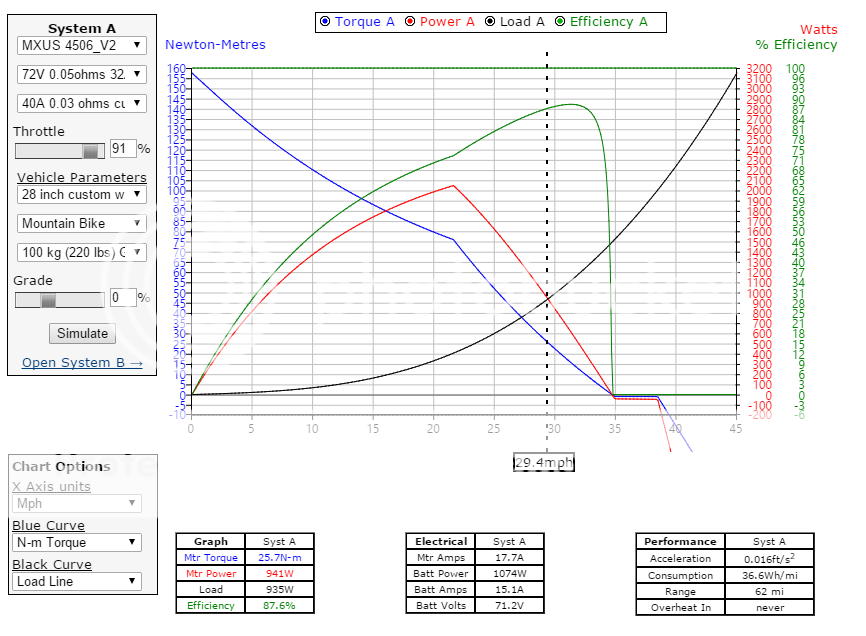

eTrike wrote:@korpin Based upon ebikes.ca sim testing (using average values of 4T and 6T) and user reviews I think you should be fine at that peak power. Upgrading phases to ~6" outside of axle should alleviate potential concerns, but your phase amp info from other thread is within limits.
From Teslanv post a few pages back:
5T (extrapolated from other motor data and ratio of strands of copper in the windings) :
Max. Continuous Phase Current: 35A
Overheat in 10 minutes: 54A
Overheat in 60 seconds: 154A
He noted that this is for non-ventilated motor and ebikes.ca info, so overheating time should be considerably longer in the real world.
http://endless-sphere.com/forums/viewto ... A#p1062179

Heads up... The MXUS 4505_V2 (5T) is now on the ebikes.ca simulator.

teslanv wrote:Heads up... The MXUS 4505_V2 (5T) is now on the ebikes.ca simulator.
It is amazing how it outperform the old 5305 !! I simulated those for fun and the MXUS is way higher performance!

OK I've been playing around with the simulator, 3T compared to 6T.
I see how the torque line can match, upping the controller amps and changing the diameter of the wheel. That makes a lot of sense now.
However I have a fixed controller, and a fixed motor (fixed = factors you cant change), and the only factors I can change are the battery and wheel. Which is my case.
The battery I can have increased voltage to increase speed. Increase amps to increase torque, I guess that would be on the phase, and changed in the controller. Is anyone putting 242A to the phase? Can the Lyen 18fet handle 242A on the phase for 60seconds?
3T:
Max. Continuous Phase Current: 55A
Overheat in 10 Minutes: 85A
Overheat in 60 seconds: 242A
4T:
Max. Continuous Phase Current: 42.6A
Overheat in 10 minutes: 66A
Overheat in 60 seconds: 186A
6T:
Max. Continuous Phase Current: 30.3A
Overheat in 10 minutes: 47A
Overheat in 60 seconds: 132A
Generic Winding Phase Current Limits per strand:
Max. Continuous Phase Current: 2.84A per strand
Overheat in 10 minutes: 4.4A per strand
Overheat in 60 seconds: 12.4A per strand
The wheel size difference does not show up on the graph in terms of torque, but the speed changes I see.
Efficiency seems to be 6% difference, until 28km/h when it reaches 10% diff. The higher eff is 6T.
This efficiency leads me to think the 6T is better then the 3T, but the above quote prooves me wrong.

markz wrote:OK I've been playing around with the simulator, 3T compared to 6T.
What size tire would you prefer and what top speed are you shooting for?
A Smaller wheel will result in greater acceleration and climbing ability, but a larger wheel will generally provide for a better ride experience. A higher Kv motor (3T) will be more efficient in a small diameter tire and faster overall, while a 6T motor can handle larger tires like a fat bike tire much better without overheating, and provide greater overall torque and require less current to do so.

Here are two different simulations of the MXUS 45mm Motors:
The first simulation is a MXUS 4504 (3T or 12Kv) winding in a 28" Tire, with a 36V battery and an 80A Controller.
The second simulation is a MXUS 4506 (6T or 6Kv) winding in the same 28" tire, but with twice the voltage and 1/2 the current.
All other parameters are identical.
In therory, the Myth says that these should be identical performing systems.
You will notice that the 6T winding has a higher max speed than the 3T, so if I reduce the throttle down to 91% on the 6T to match the max speed of the 3T set-up, I get the following:
And here are both 3T and 6T windings overlaid:
Conclusion: While a 3T MXUS may be able to run fine in a 28" (Fat) Tire without overheating, it is NOT as efficient as a 6T with twice the voltage and 1/2 the current.
