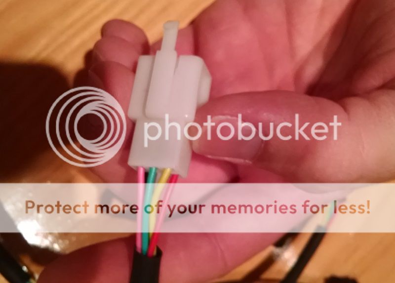

Re: MXUS 3000 Hub Motor
Post by teslanv » Jul 25 2015 9:59am
cwah wrote:That's great. It brings lots of clarity now.
Just 1 more point... if I don't have the lcd display it is ilunlikely it will work I suppose? :/
I think it will work without the LCD display, but you won't have any way to adjust the settings.
I am kinda surprised that you got one of these controllers without the accessories. Where did you get it?
Post by Rix » Jul 25 2015 10:05am
[quoteThat's all I know, bro][/quote]
Yah, your assistance with photos just laid the basis for a pseudo wiring diagram. Nicely done Tesla NV. Speaking of your avatar name. I drove out to the Gigafactory site. The guards wouldn't allow to pass the entry control point. So I snapped this pic and turned around. I find it rather peculiar that your name is TeslaNV and Tesla's Gigafactory is located between Reno and Fernely in northern Nevada. :wink: :?

cwah   10 GW
Posts: 4214
Joined: Jul 24 2011 5:42am
Location: Between paris and london
Post by cwah » Jul 25 2015 10:49am
I got it from Vampa........ :(
How much would it cost to ship the accessories?

cwah   10 GW
Posts: 4214
Post by cwah » Jul 26 2015 5:40am
Tesnislav,
I noticed my controller doesn't have the LCD connector:
Would the connector be instead used by the CA connector?
Also, I think I'm going to have a go, and to start obviously I'd need to solder the on-off switch together. Any clue which one that might be?

I changed the connectors and now I'm on the tricky part. From the picture it seems that one of these is the on off switch:
And I've been trying randomly on my wires but it created a big sparkle somehow:
Any idea which one is best to connect to avoid sparkle??? Is it any of the other wires on the black?
Yeah you dont want to be doing that.

New tentative...
Trying to connect the pink and black created a big spark....
It's too dangerous, i can't do trial like that :(

No no, but its normal for sparks when you connect the power wires. Need anti-spark connectors.

The problem is that i don't know if the spark is normal or not. It can be a short too!
What should i do?

The bottom one looks like a CA plug.

Post by markz » Jul 26 2015 9:26pm
Need to find the throttle cable too, it should be three wires.
cwah wrote:I changed the connectors and now I'm on the tricky part. From the picture it seems that one of these is the on off switch:

I aleeady connected the throttle wires thst should be the one mentioned by renislav picture. But the on off switch I can't find a way to figure out which one it is
