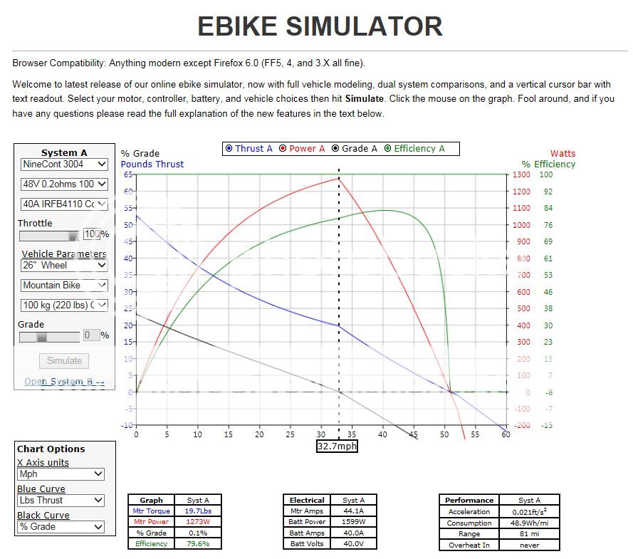

OK. I did a test on the ebikes.ca simulator with a Nine C 3004 Motor.
Spec shows Phase resistance of 0.082 Ohms.
http://www.ebikes.ca/shop/ebike-parts/m ... 004rc.html
I ran a simulation (see screen shot below), and came up with a peak power draw of 1599W from the battery, and it gave the motor 1273W of power, for a net loss of 326 Watts (Waste/Inefficiency).
It also notes the Motor Amps (Phase Current?) at 44.1A
If I do the math on that one, I come up with 44.1^2 x 0.082 = 159 Watts of Heat. So this is telling me the Calculation for waste Heat is either low, or there are other major inefficiencies that are also contributing to power loss besides the resistance of the phases.
Anyone have any insights they can share?

\/ampa   100 W
Posts: 255
Joined: May 15 2014 2:54pm
Re: MXUS 3000 Hub Motor
Post by \/ampa » Jan 26 2015 1:54pm
The ebike simulator also calculates the controller losses + wind and rolling resistance.
I think we have first to determine what phase current rating for a controller means.
Is it the average amps flowing in all 3 phase wires over 1 secound or what ever?
Or is it the max. flowing in 1 (or 2) phase wire at any time?
Maybe something other?

teslanv wrote:OK. I did a test on the ebikes.ca simulator with a Nine C 3004 Motor.
Is that the motor closest to the MXUS 3000 on his simulator? And what would it take to get Justin to add in the MXUS line of motors to the simulator?

arkmundi wrote: Is that the motor closest to the MXUS 3000 on his simulator? And what would it take to get Justin to add in the MXUS line of motors to the simulator?
Not really the closest motor to the MXUS 3000W. The CLyte TC40100 would be closer [40mm Magnet, 100kph speed (higher Kv)]
http://www.ebikes.ca/shop/ebike-parts/m ... 00r26.html
Swapping the motor to the TC40100 nets nearly identical results at the peak power point on the chart.
44.2 Motor Amps, 1594 Watts Battery, 1282 Watts Motor, 312 Watts total system Waste.
Phase wire resistance on the TC40100 is 0.07 so 44.2^2x.07 = 136.7 Watts of Phase resistance Loss.

\/ampa   100 W
Posts: 255
Post by \/ampa » Jan 26 2015 3:05pm
Now i have it. :lol:
The resistance measured is already from 2 phases not 1 PHASE. So the math is true.
