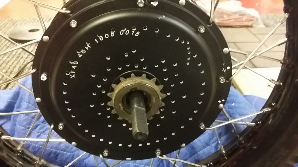

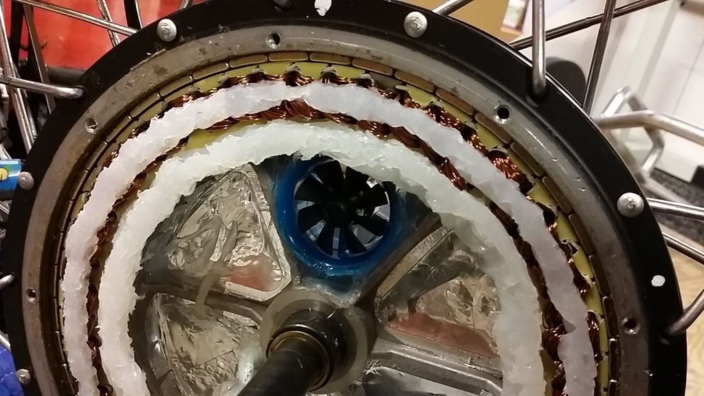

I've decided to air cool my Mxus motor. While FF will work good for most, I decided I wanted the maximum performance.
I can't see how FF can do better than a strong airflow constantly directed through the windings. When I'm pulling up that long steep hill at a slow speed, there will probably be more airflow through my motor than on the outside heatsinks of a hubsinked motor.
I'm ready to test, in a contest, my setup against a FF user. Yes I know you FF users seem to think your setup is better or best, but I disagree and am ready to test it. I don't want to get into the theoretical discussions about how FF + hubsinks are better, I want to see actual performance numbers.
My setup works by blowing cool, outside ambient air, over the windings and then exhausts the air out side, bringing in only fresh cool air.

While I am fairly certain FF + heat sink will win, I applaud the effort Offroader. Now lets hope there are riders with FF+heat sink in the north east that will do a ride along to compare real life results. The result will speak for itself.
Where have you dug your thermistor in the motor? I guess thermistor is required to get results worth comparing?

Like I said, I don't want to debate the theoretical advantages of FF. The reason is there are too many variables in a hub motor. The windings are not sitting in oil directly on a frying pan.
There are thermal bottlnecks for the heat transfer, the windings are inside the hub are surrounded by plastic and somewhat air gaps. The heat has to transfer through about 10mm or more of steel. It has to also transfer through the FF probably by mostly convection.
Too many variables here to just use a simple chicken boiling on a frying pan.
My cooling method is simple, blow the hot air right off the windings and out of the motor with a very high powered RC jet fan.
If you had to cool chicken, would you rather blow air directly on it to blow the heat off of it or would you slap it on a frying pan, better yet slap a chicken on 5 mm of steel with no oil on the chicken, that would be like the windings are suspended in the stator by plastic and air gaps., and then use some FF to connect the 5 mm of steel to the frying pan.
I've thought about this for a long time, and in my opinion, I can not say for certain FF + hubsinks would be better. That is exactly why I want a contest with someone. It could be better, I could be wrong.

macribs wrote:While I am fairly certain FF + heat sink will win, I applaud the effort Offroader. Now lets hope there are riders with FF+heat sink in the north east that will do a ride along to compare real life results. The result will speak for itself.
I'm just using the thermistor where MXUS placed it in the windings. You see the biggest issue I have with FF is the peak cooling rate, this is when you are riding at full throttle, 7,000 watts on my bike, and only going 10 MPH up a steep hill.
The problem with FF is the windings are wrapped in plastic and there are airgaps around the windings because of this. FF is not going to be able to do much for this, so when you start really heat those windings up there is going to be a thermal transfer problem with just FF.
With air cooling, the windings will be getting hit with high air flow, so when the windings are at 110C and getting hotter, they will quickly be hit with cold outside air and the heat blown right off them.
Remember, my motor will also cool the stator, at the same time the windings. So I have the same buffer as FF, that is the stator soaking up some of the heat. I'm just cooling both the stator and the windings, while FF is just cooling the stator. But the argument for FF is that it will shed heat off the stator faster than forced air. This could be true, but it won't shed heat also off the windings like forced air will, FF will do nothing for the hot windings, or the rest of the stator that FF does not touch.
I've already used for 2 years the same cooling setup on my cromotor, and it worked perfectly where I never had overheating issues. So the air cooling works, I just modified it in my MXUS motor with a bigger fan and a more efficient air flow to really cool the motor down quicker when I need it. This isn't a question if my air cooling works, it works great. It is just that my new setup is much better, and I want to prove that it will easily blow away a FF hub motor.
FF will work for most people because they don't push their motor in extreme conditions like these, and after they heat the windings somewhat, they can wait for the heat to transfer out of the motor.
We shall see, I can always switch over my motor to FF and hubsinks, and just epoxy up the holes in no time.
