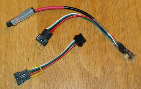

Kingfish   10 GW
Posts: 4064
Joined: Feb 03 2010 11:23am
Re: XPD: open-source keywin e-bike lab replacement
Post by Kingfish » Sep 25 2012 7:21pm
Yer right; it's confusing. :?
I have #1, and Lyen is sending me #2 with the Controller; I'll take pics of both when #2 arrives. Then we can play pin the tail on the Dongle, er... Controller.

Kingfish   10 GW
Posts: 4064
Post by Kingfish » Sep 26 2012 9:13pm
Greetings Flashers!
I received the controllers from Lyen today and it included the adapter to the Adapter as imaged below:
The top one is the original (#1) Programming Adapter cable: The top-left connector is 4-pin and plugs into the USB-TTL serial board (not shown). Just below it is the 5-pin connector that typically mates with the associated cable exiting the controller. To the right is the momentary push-button that closes the circuit and facilitates programming (natch).
The short cable below #1 is the MII extension required for the “Infineon 3” class boards. The right side literally plugs directly into the upper cable – between the Adapter #1 and the controller. It is about 5 inches long.
Using the Lyen_MK2_V2.01_2012.exe application, I was able to flash the brand new controllers without issue. Then I rolled the ebike over and proceeded to flash the new modified & mounted controller in the blink of an eye.
Conclusion: I needed that extension cable. :wink:
It’s late but I’ll test the XPD app in the AM; I do not anticipate any issues.
Many kind thanks to the vigilant contributors <bowing low in your general direction>
Yippie-yi-yo-ki-yay, KF 8)

ohzee   1 MW

Make's me wonder if you could just take an original cable and add a jumper for the 2 outside pins. Maybe with a switch depending on what rev.

Alan B   100 GW
