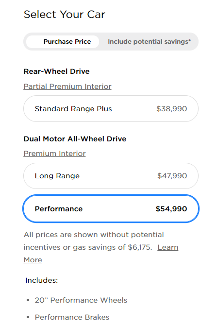

Post by TheBeastie » Jul 16 2019 8:08am
Saw this on Twitter
Apparently, they are really giving away the Tesla Model 3's now.
The M3 Performance was $73k late last year now you can get it for under $55k now.
https://pbs.twimg.com/media/D_kPjeZUIAE ... name=small
This Reddit guy (seems to be typical for Reddit people are the most clueless), he got a M3-Performance last quarter for a price premium and it ended up being riddled with defects, didn't carefully inspect his car on delivery, and its going to take a while for it to get fixed, and now he's just found out about the new price cuts.
https://www.businessinsider.com.au/tesl ... ?r=US&IR=T
