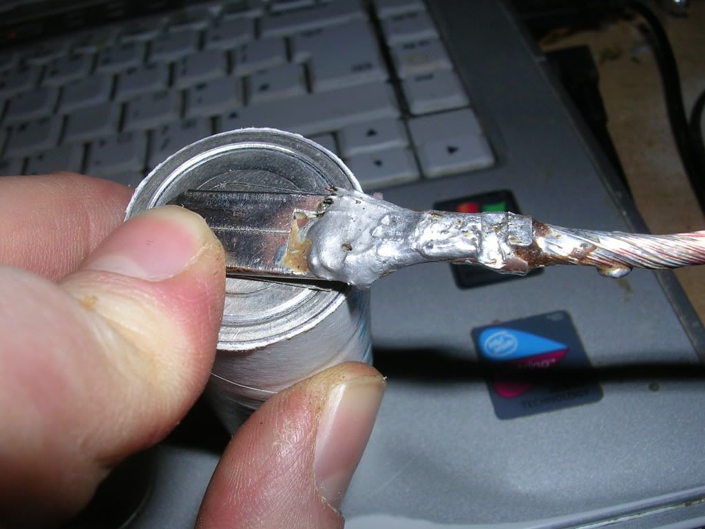

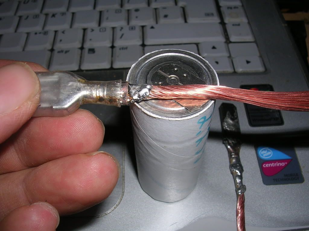

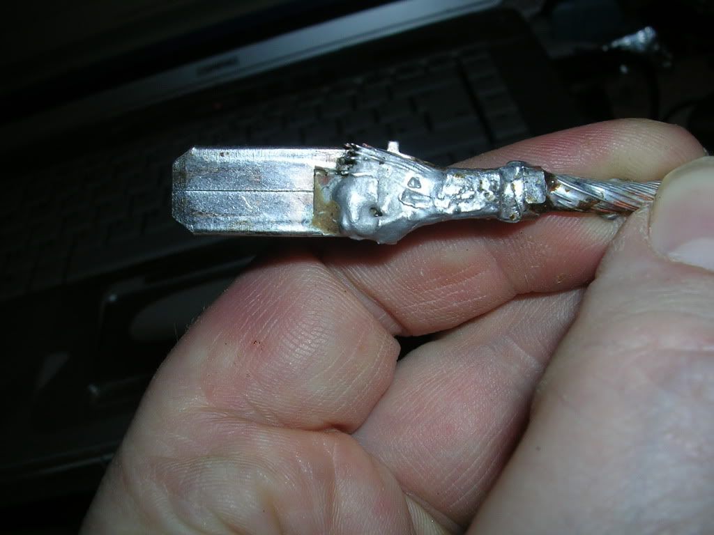

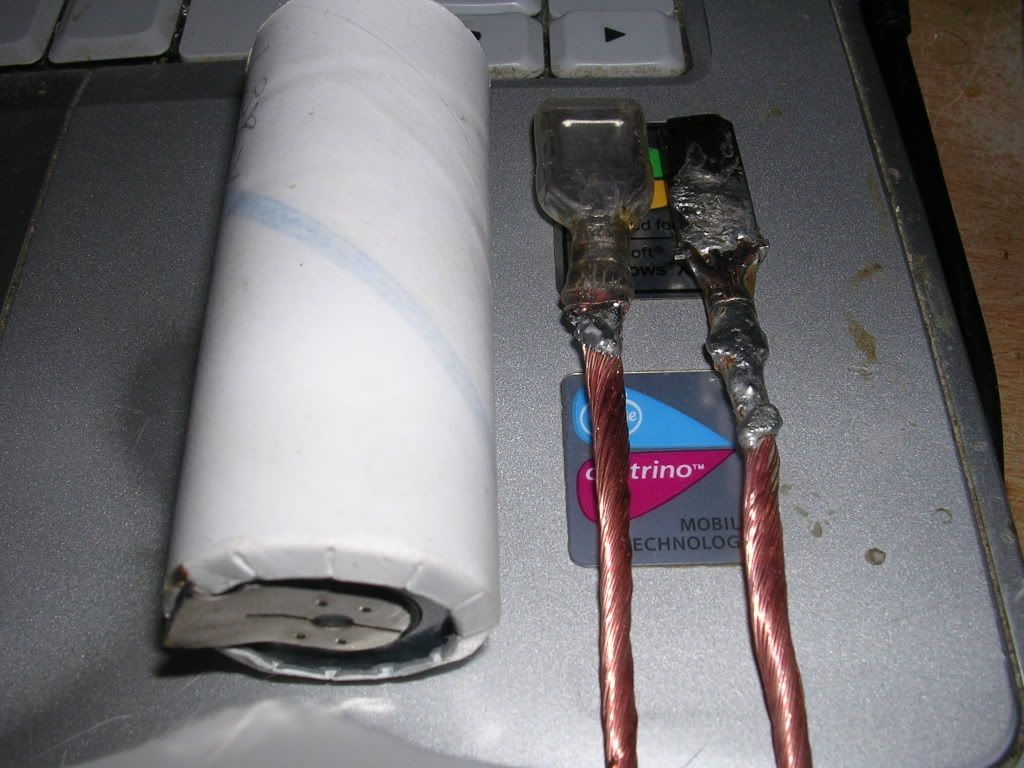

Post by The Mighty Volt » Nov 10 2010 8:08pm
Good for 100Amps???
Above is a 1s10p sub-pack of A123, tabbed cells, finished with copper wire and shim.
What I now need to do now is terminate the pack so I can join them up in series. I got some female and male spade-ends from a friendly ES member and they seem to fit well into 9AWG wire. {6mm2 European, its around 9-10 AWG}
It should be noted that the sub-pack is already connected with suitably heavy and conductive materials.
These spade-ends and the length of wire are only needed to terminate each sub-pack. I was wondering what people thought about the Spade-Ends and their ability to handle long bursts of 100A peak.
Lyen thinks they are good to go, and sure enough he uses them on his controllers, I just thought I would throw it out there and see what everyone else feels. Thanks.
