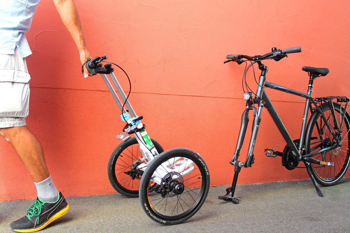

With rear rack
or even this one on a suitable folding bike(with rear rack + panniers for gear
Edit : Daga stroke - tilting cargo trike This one might just be it for me in terms of capacity and weight distribution (battery at its lowest point should improve stability and handling)
The only thing I would be tempted is to also have a way to fold/disassemble and bag everything to comply with public transport logistics.Granted the weight will likely be significant
enough...will have to revisit/re examine when I get close
Thanks this has gone in a very exciting direction for me.

those kinds of things would work, too, and give you even more cargo space. but i was thinking of stuff like these that have racks as "part of the frame":
https://electrek.co/2018/08/27/electrek ... -part-suv/
https://www.perennialcycle.com/shopcast ... e-project/
and others; there's several here on the forum too including a couple of complete custom builds but i can't find them right now.

Did a test with 13s 20ah cells today. I am guessing the added weight is under 25kgs but the results are challenging enough to put any more weight on hold.
Wheelie's - yes definitely an issue. I gathered because I placed the added weight in a top box on the rear rack - the front hub is struggling. If I move the weight in the triangle area if the frame it would help with wheeling but the weight will sit a lot more on the front fork and the hub is already near the limit to what the dropouts can take(vibrations, and generally feeling like it's stressing too much).
The wobble - yes : the added battery is too high in too far away from where the motion is generated and handling is compromised to a point of no joy.
Too many issues to go on. The way forward is through something like the Daga stroke trike frame design. Batteries can be placed low and that's a good place to explore handling (thought the battery could be better off made to swing so that everything remains lighter to lean the bike one way or another - agility with the wrong design compromises the fun when the overall bike is heavy.

Did a test with 13s 20ah cells today. I am guessing the added weight is under 25kgs but the results are challenging enough to put any more weight adding on hold.
Wheelie's - yes definitely an issue. I gathered because I placed the added weight in a top box on the rear rack - the front hub is struggling. If I move the weight in the triangle area of the frame it would help with wheeling but the weight will sit a lot more on the front fork and the hub is already near the limit to what the dropouts can take(vibrations, and generally feeling like it's stressing too much).
The wobble - yes : the added battery is too high and too far away from where the motion is generated so handling is compromised to a point of no joy when riding the thing :o
