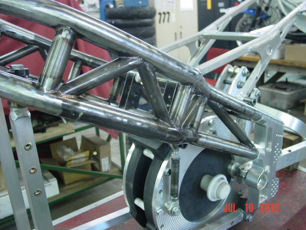

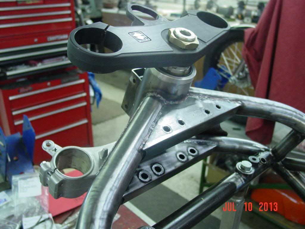

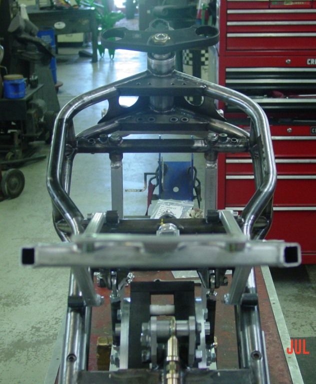

Some final pics before it all gets crated up.
The headstem bearing ODs were based on a GSXR, so I ended up buying an '08 Gixxer front end in the USA and had them throw it in the box. They tried it with an older triple clamp and it all fits good. Still need to source some brakes and levers.
Bit of a fatty, but no fatter than a typical non-Honda Japanese litre bike.
Looking nice and shiny :)
Got the holes machined out to 20 mm, which is still probably too small for GSXR rear wheel. Oh well. I should have been more specific than "about 20-25 mm". I can still make it work with spacers.
Randy is still working on the output shaft bearing and support. Still quite a lot of support needed for this much torque. And once this is paid for, I will be almost completely broke. Time to get that crowd funding target set up...

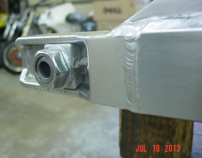

Post by jonescg » Jul 12 2013 9:00pm
Some last pics to show you before it gets sent off. I got Randy to build an output shaft bearing support, as the chain run would foul the tyre unless the motor was shuffled further to the left. We couldn't go too far as the motor would end up touching the inside of the swingarm bridge, so it meant mounting the drive sprocket some way out. In order to support the shaft, the new bearing goes to the inside of the drive sprocket, leaving full access if you needed to remove the chain.
He also added some attachment points for the all important sharks fin sprocket guard, and some spools for the track stand.
Finally the bump-stops for the steering. Don't want to chip the paint now!
