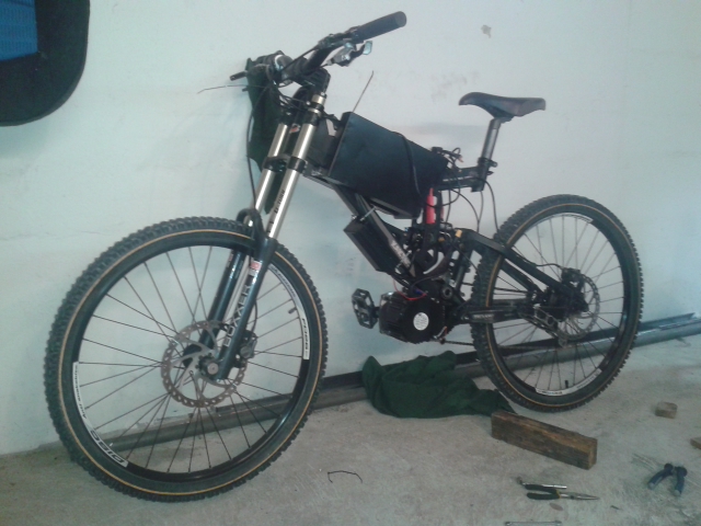

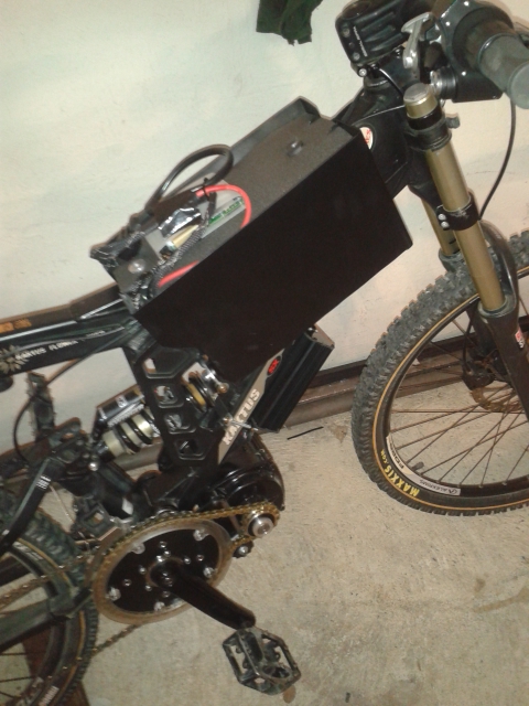

Re: Vario downhill bike mid-drive conversion
i have try the bike today.
need a little work to finish it.
battery is 16s7p Sanyo GA, splitted in two parts.

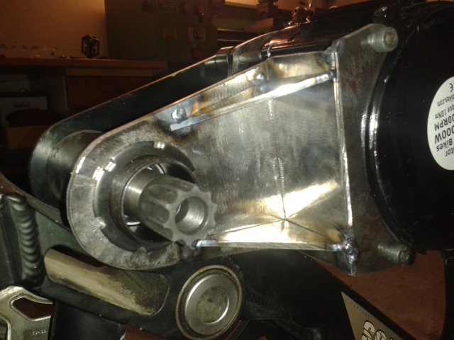

custom motor clamping is done. I weld a plug with M6 tap below the down tube so it's invisible. Now waiting for battery pack, chain and chain tensioner. https://i98.servimg.com/u/f98/19/13/15/28/20190311.jpg https://i98.servimg.com/u/f98/19/13/15/28/20190312.jpg https://i98.servimg.com/u/f98/19/13/1...

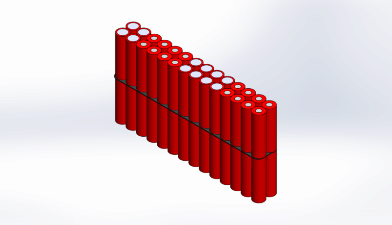

7s8p x2 good or no ?
Hi all,
I need a custom battery for my build.
Is it a good setup to build two 7s8p like this and connect them in serial with one bms to make a 14s8p battery ?
I don't have enough space in my frame so plan is to put packs on the sides.
this is the left motor mount that i'm start to build.
it's a 3mm sheet metal.
is it correct to build two packs for example 7s4p and connect them in serial for 14s8p ? Looks like a fun build. Two 7s4p packs connected in series would be 14s4p. A 14s8p pack split into two equal halves would be 7s8p. yes, i made a mistake when i write it. so, is it a bad thing to build a pack sp...

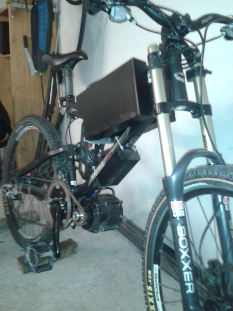

Hi all, I starting convert this great downhill bike. I have just ordered the classic cyclone 3kw kit. i'm planning to fit battery on the sides of the top tube (rectangular shape) is it correct to build two packs for example 7s4p and connect them in serial for 14s8p ? Or perhaps a rectangular 14s7p c...
